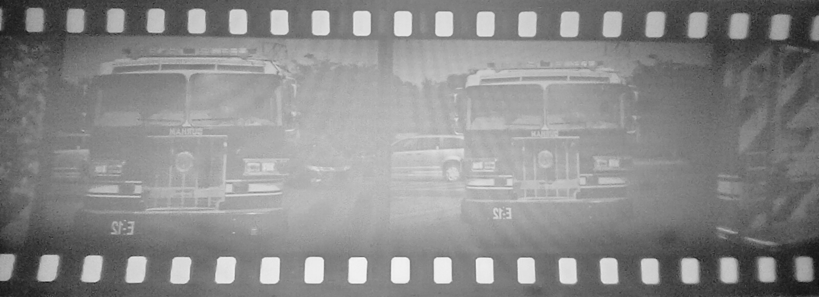

Hey folks - I've taken a loooong hiatus, and finally decided to return!
Anyways, I picked up a couple rolls of FPP (Svema) Super Positive film. I used it a few years ago, and things came out great, this time, not so much.
I've attached a picture that I snapped with my phone, with the film against my MacBook screen, so sorry about the moire artifacts. They look denser here than in reality.
I used D-76 in the past, but all I have with me on the moment (I'm on vacation) is Ilfosol-3. Roll 1, developed in 1+9, 7 minutes @ 21c. The results were super thin. I
Roll 2, I shot a couple of blank frames with the lens cap on to see what the density of "black" would be. Souped 10 minutes, same thing, though [just] noticeably darker. The images are there (and damn, are the gorgeous), but they're not easily viewable unless I place the film on a solid white surface.
I don't have a densitiometer, but I set up my lux meter under a tungsten lamp. Placing the dark frame of the film over the sensor cut the reading by a factor of 4, which works out to an OD of 0.6 [the base-10 log of 4).
The highlights are absolutely crystal-clear.
I shot both of them outside, in bright sun, at ISO 0.8 (metered at ISO 6 and exposed +3 stops). Even though the film is ortho, I loaded it into the tank in the dark, no safelight. I have no idea what happened or why they came out like this.
Anyone have any experience with this film? Did I massively under-develop? Did I somehow manage to fog it? I'm tempted to try another roll in D-76, but it's expensive, and not exactly a practical film stock, as novel and fun as it may be.
If anyone has any input, I'd tremendously appreciate it!

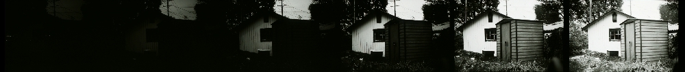

I've got a bunch of this rolled from bulk in cold storage... so much for my inventory skills. Might try a series of developers this evening.
I posted about this film some years ago and recall the distinctive yellow tint when scanning as a color positive.
Dec 29, 2018
982
USA
Traditional
Nope, not in any of the prior examples IIRC. I shot a few frames after lunch today all within 1-2 stops of each other (around ~f2, 1/30s). My 'darkroom' isn't light tight so inspection wasn't a ready option.
After 3 minutes in stock D-19 (first attempt, at random) exactly one frame showed any detail.
Presumably this represents underexposure, but I rated at 0.75 ISO. Maybe it doesn't store well, even when cold.
It is capable of producing 'normal' slides for viewing & projection, but not this time.

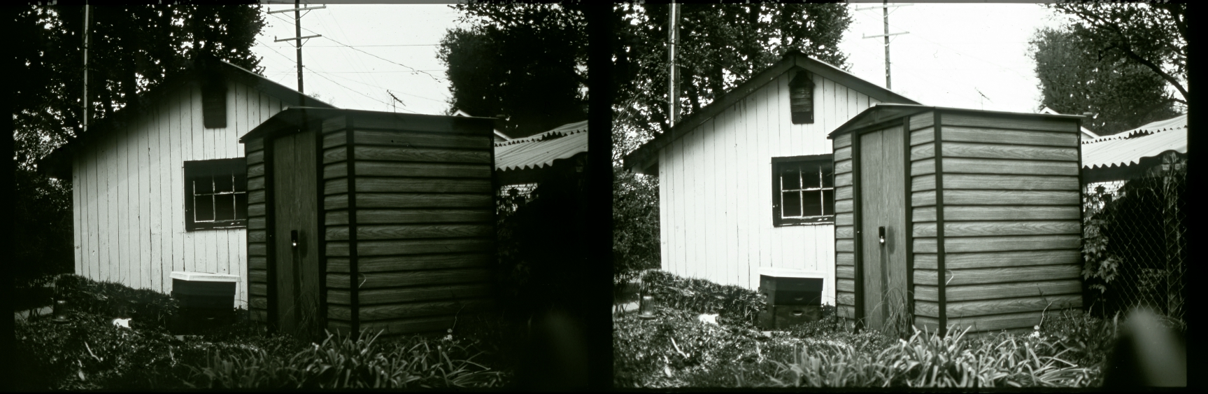

That formula & time provide better results than something random off the shelf.
FPP Super Positive @ ISO 0.75 (f/1.8, 1/30s); -1, 0, +1 ... +4
UP-2 stock, 5' rotary @ 74F
The +2 and +3 frames are decent.
It was overcast today so maybe that or underdevelopment/film age accounts for the apparent speed loss.
