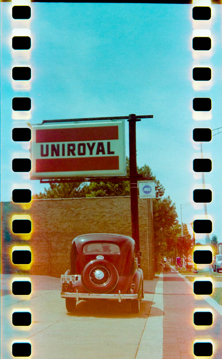

Thank you for the link Agx. My brain processes old cameras and films, better than computer stuff. I studied the Svema negatives, no edge markings of any kind. There appears to be some kind of light bleed thru on some sprocket holes, don't know if it came from the camera or in manufacturing are in the c41 process. I'm running a roll of 200 Foma bw thru the Zenit now and will check for the light leaks again. J.
I have several rolls of "Svema 125" that I got as freebies from FPP. I home process, so I can tell you for certain that these are hand-loaded, used commercial film cassettes. They tape onto the tail of the film that was originally in the can, and bulk roll it like a reusable cassette. The light leaks you've mentioned only seem to make an appearance on the first one or two frames of the examples I've seen, with the film before it being completely overexposed, so I think that leakage is the result of their hand loading from bulk rolls. Personally, I like the effect it has. As it has no pre-exposed edge markings, I also like it for rolling onto 120 and 620 for my MF cameras.
