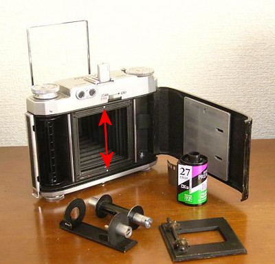

The engraving on the cover plate and a quick internet research made it clear for me. The camera shown in the first video is a later model with 5 digit serial number engraved "Press Van-120" 10xxx serial no. - my fault. And I only found these two versions of the Press Van.
This is what fs999 probably owns:
http://camera-wiki.org/wiki/Press_Van (the 135 adapter stuff is also shown)
Yes, this is it !

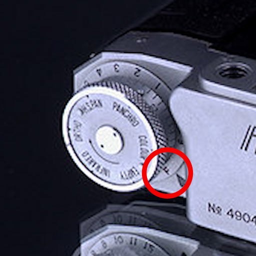

I think I have found how to do.
When a film is finished the arrow is in front of the F mark and you can turn the knob as long as you want it stays there.
Now if I put the slider on the left on 35mm and back to 6x6 when I turn the knob it advances to mark 1.
So I have now to find the starting point. I will try this evening and make some photos...

For those who want to know. Here is the way to load a film on a Press Van (not Press Van 120 !)
First verify that the mark is on F and the slider on 6x6. Then put the film on the right side and put the paper in the left spool and turn the knob until the double arrow points to the white dots in the middle (see photo).
Close the back. Slide the swith to 35mm/Free and back to 6x6. Turn the knob until it blocks on mark 1.
Little hint : when you forget to arm the shutter before pressing the shutter button, close the lens panel and open it, then arm the shutter and you can press the shutter button without loosing a shot.
