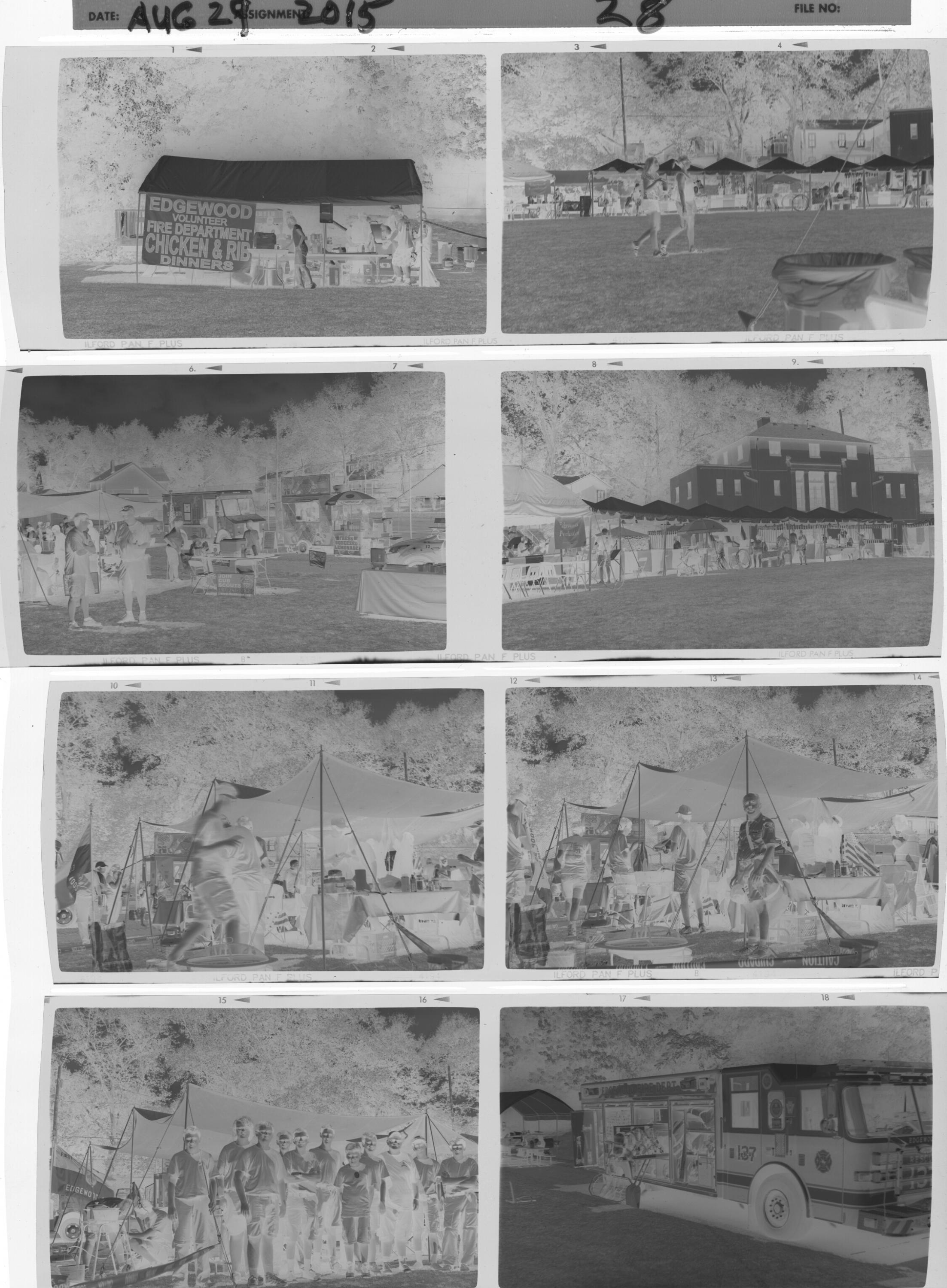

4rolls of 6x9 were shot Saturday. The first was PanF50 in a zeiss Ikon 515/2 f4.5. It was Edgewood Day Fair and shadows were black under tent booths in the bright sun. Sunny 16 was used. 1/50 f16, yet, after the film was developed that night, there was no high contrast in it. There is massive detail in darks, what I thought would be pure white negative. Awesome.
Delta 100 did the same thing. Lots of soft gray detail- everywhere. 1/100 f16 for most shots.
Every shot turned out to be good.
FP4 has more contrast in the negatives than the other two do. But still massive detail in what should be underexposed areas. I thought.
They all were developed according to normal directions. 68 degrees in D-76 1:1.
This is a wholly unexpected result.
Not that I'm displeased, mind you. Just really surprised.
The last 2 rolls were shot in a Voigtlander Bessa. One shot was a portrait at 6 feet focus, wide open, f3.5 under a tent and the background is not black outside on the negative. There is lots of blurry detail there. Focus was good enough to resolve individual hairs on the head.
These films really suck in detail in dark areas when exposed for bright light!

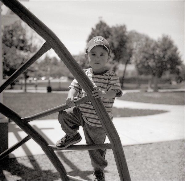

The reputation for Pan F of being a high contrast film is undeserved in my opinion (especially when postured as if this is a troublesome feature somehow!) Its usually from uninformed people not working with it very closely or who tried it once or twice and wrote it off, or who have certainly not experimented enough to get it dialed in properly. I find that key, if shooting in high and contrasty lighting, is to add just a little bit of extra exposure and then pulling back 10-20% in development times (to ensure at the most that you don't overdevelop, Pan F does not like over development). Do that and you're going to get beautiful and subtle shadow and highlight detail.
Below was taken on Pan F on a clear bright and sunny midsummer day. Heck the film caught more shadow detail than my eyes did when viewing the scene!

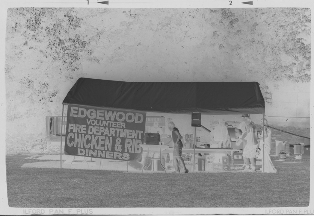

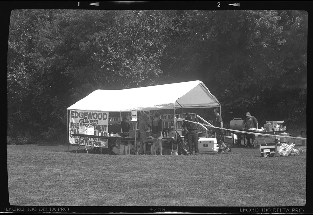

This almost same shot was also taken with Delta 100 and the tent top is black, here, in the negative with PanF50, detail shows and is a better film for that reason, lower contrast, but there is also just as much detail under it in the Delta 100 shot. I can almost read the paper posted in front if I zoom in on a 600 dpi neg. These were scanned through a plastic sleeve. There is flair above the tent roof, and or it is smoke from the cooker. I could not see under the tent from where I was taking the photograph from. It was black under there. Yet, I can see peoples faces in the image.
Well, if "flair" increases detail, I'm all for it.
This is the blank roof Delta 100.

One is a PanF negative and the other a Delta positive which makes comparisons more difficult but there is clearly detail in the tent roof in the PanF negative which I assume would show in the print whereas in the Delta 100 print the tent roof is clearly blown.
I wonder if this is down to the two films or might it be explained by a difference created by an exposure or development aspect?
I have to say that your experience with D 76 and Pan F should encourage those put off by the so-called temperamental nature of Pan F to give it a try
They all look to be great negatives which should print easily

It was posted like that so the film type markings would be seen. The panF print does not show the film name.
The Delta blown roof will show detail after contrast is reduced as much as possible in the computer. It would need careful burning in in the darkroom and a 1 1/2 contrast filter at least.
Exposures were generic sunny 16. 1/50 f16 pan f and 1/100 f16 delta 100. Same camera. Zeiss ikon 4.5
