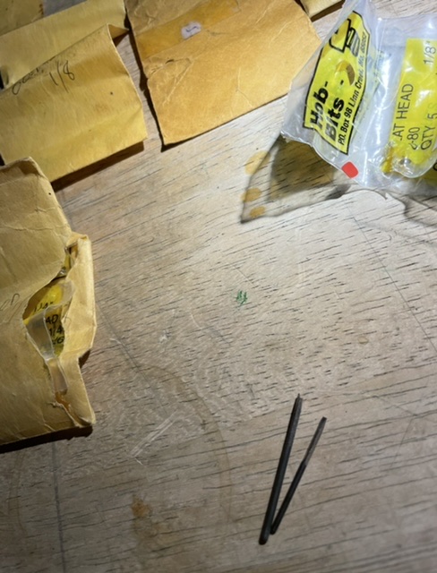

Taps aren’t a bad idea. I have 1-72, 0-80 and 00-90 with the corresponding drills and a variety of screws and nuts that come in handy from time to time.
Sometimes you can just twist the taps between fingers
