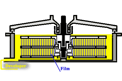

Hello Tom,
Yes it is. Which tank are you looking at? There are two sizes (very similar) that do 35, 16, standard 8 and super 8. There are also some larger less common ones that are water jacketed. There is also a Meopta one that only does 30ft of 16mm or standard 8mm (which is 16mm wide before splitting). I have 3 of the 1-35, 2-16, 2-standard 8, and 2 super8 types and the instructions, which used to be online, but don't seem to be there any more. You can load 2 super8 films, but the second one can be a little tricky, because you have to attach more parts before loading. These tanks work very well, and are easy to load, after you get the knack of it.
Cheers,
Clarence

Hello Tom,
If you are looking at the tank similar to the one I posted, there are a variety of plastic parts that allow either one 35mm, one or two 16mm, one or two standard 8 or one or two super8 films to be done. To do the second layer one adds the included plastic ring and other parts and loads. This has to be done in the dark. There is only room and parts for one 50ft length of 35mm.
I am not aware of a Lomo tank that does not have all these parts. I checked my 16mm only tank and it was actually made by Chemoplast in BRNO.
I will post a few more images in the next post.
Cheers,
Clarence
