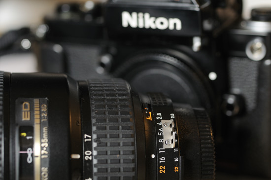

Sorry, technical difficulties above.
Can AF lenses be fitted with AI/AIS aperture setting ears?
Yes, quite easily, once you acquire the two tiny screws and prong. AF lenses, at least those with an aperture ring, have two very small indentations (just left of f4 and f8) to mark the precise location of where holes should be drilled in order to affix screws through a metering prong. I can't recall bit size. The aperture rings are plastic so I don't feel it's imperative to tap the holes. Not tapping has not posed problems.
For those that have a Dremel with an appropriately tiny bit, it's straight forward. No need to remove the aperture ring from the lens. For those that don't have a Dremel or the ultra-tiny bit, take one of the screws and lens to a reputable watch repair shop and pay them the nominal fee to drill two holes, radially. They'll need the screw to ascertain bit-size. Before mounting the prong, place a very, very small droplet of Loctite on/in the holes and then tighten the screws. Here's a 17-35 f2.8 AF-S ready to serve the F2SB.
