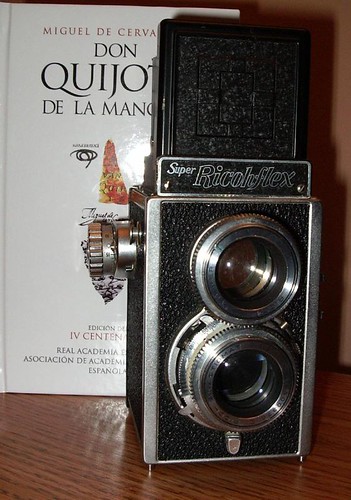

An older gentleman gave me a Super Ricohflex.
The camera has some 20-year old film in it, and the film transport feels very stiff.
Is it due to the old film, or is there something I should pay special attention to, beside making sure the spool is in the right spot, and maybe inspecting parts involved in detail?

It could be both the mechanism and the film, but undoubtedly the film is brittle and "set" in the camera.
Don't try to force anything. I would remove the film immediately.
If you wish to try to process what is on the roll, take it to a dark room or get a changing bag to remove the spools and wind it on by hand.
You can damage the camera by trying to force the film through the film path.

Well, after removing the old film which had a serious crease, and close visual inspection of components, film transport works fine, unloaded.
The advance knob is a bit stiff, perhaps by design?
Neat machine!
I have to learn how to handle 120 film.

Could be dry or with stiff lube. If you are careful, you can disassemble and clean the advance with naphtha. If you feel you have to lubricate it after cleaning, use ONE drop of a good synthetic oil; NO MORE. Work over a surface that is covered by a cloth so parts don't bounce off. Take pictures as you go and you'll be fine. Otherwise, you could try squirting a bit of naphtha down in the advance to see if that will free it up.
Here's a tutorial on cleaning this camera... [

I have one of these. The lube dries out. My lens was frozen up and I disassembled it and re-lubed. It's a very simple camera but it gets the job done. Does has some pretty strong vignetting though.

YOur advance mechnism has a lever and a button? that is the autostop transport, and it is stiff by design
The main issue I've found on these cameras y the need to flush the shutter with ronsonol and add a small dab of moly-grase on the shutter
Other than that they are pretty sturdy
