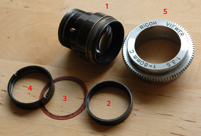

help with focus?
I'm trying to calibrate the focus on my newly aquired Ricohflex. The taking lens was easy to do, but I'm having trouble getting the focusing lens to focus at infinity. It seems that the lens needs to be closer to the mirror in order to focus at infinity, right now when I put the lens in and push it as far back as it goes, it's focused at around 2.5 feet. From there, it only rotates out (focusing even closer).
I attached a pic of the parts from the viewing lens. What I've been doing is screwing #2 onto the lens, putting that in the camera body (already too far from the mirror). Then on the inside of the camera, I slip #3 and #4 on the lens and tighten them down. If this worked then I would put #5 on, but it doesn't...does anybody know if I'm missing something?
Shangheye
Jul 26, 2007
1,092
Belgium
I never had to take mine apart this far..you could PM Andrew Moxom who I think Did....at first sight i can't see what you are doing wrong. Rgds, K
