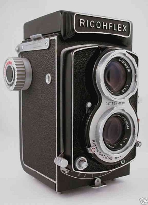

If it's geared front focusing like the first image then I think it's an older push fit design.

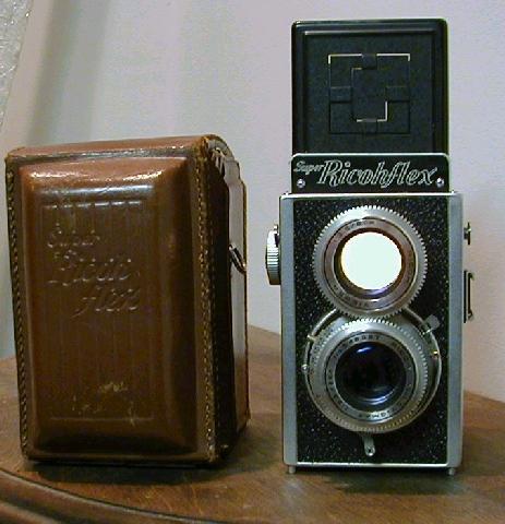

The later model shown in the second image has Bay 1 filter receptacles. These cannot rotate because if they did, the square Bay 1 fit lens hoods would not work.
I have a geared front focus Ricohflex at home (not a Super though) and I'm 99% sure it does not have Bay 1 fittings. I will check it later.

Like the first picture, so its the old model. Thanks for being so helpful Steve. Are the push fit filters easy to find (I am interested in orange, red and a dioptre..). Kal
