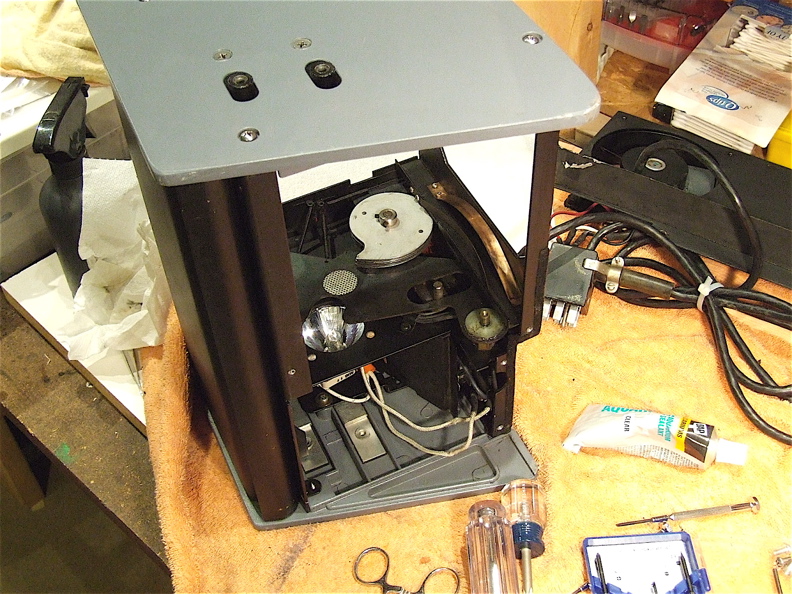

I've been working on combining the color head that came with the D5 I bought last spring, with the frame for my (much less worn and more familiar) D2. Before disassembling the D2, I've been making sure the Super Chromega D Dichroic II head works.
It doesn't.
The fan powers up as soon as I switch on the power supply (as I gather it should); the panel light operates when I move the switch behind the color filter dials. The three filters all move with the dials, and move out of the way when I switch the side lever to "WHITE" -- though the neutral filter is missing from the plate that moves in when I set that lever to "LOW", so I'm on "HIGH" all the time. I've tested my Gralab 525 digital timer, and once I found the right combination of modes, it switches power to the Safelight and Enlarger outputs correctly (tested both outlets individually with my safelight -- see why below).
Unfortunately, even after repairing the melted wire nut on one of the wires leading to the main lamp and verifying the new-looking lamp has about 7 ohms across the filament (as opposed to an open circuit if it were burned out), I'm getting no main lamp start.
Still to do, when I replace my multimeter (which failed today, by one of the probes coming off the wire -- and I can't find the spare probe I thought I had) is to check that the 24V output on the power supply is actually delivering power. Of the 7 wires in the cable between supply and head, I should have one pair at 24V (for the main lamp), one at 120V (for the panel lamp), and another pair at 120V for the fan motor, I think (why separate that from the panel lamp, I don't know).
It's not clear from the manual whether the lamp is operated on AC or DC -- DC might provide slightly better lamp life or brightness, but AC would simplify the power supply; all that would be needed is a suitable transformer powered by the "Timer In" connection on the power supply.
Is 24V output a known problem with these, or is this more likely to be a bad wire connection at the plug or an issue with my extension cord from the timer not making contact? Obviously, this worked at some point, else it wouldn't have had power the melt the wire nut -- but I have no way to know if that was with this power supply.
EDIT: And now it does. I went back and rechecked the power cord from timer to timer input on the power supply -- I'd had to trim the extension cord's outlet a little to get it in (the receptacle is a circular opening with the prongs of a standard 120V plug inside -- vaguely similar to one generation of Bosch circular saws from ten years or so ago) -- and when I pulled the cord end out of it, I could see the plastic had been deformed by the metal receptacle. I applied a sharp blade to trim down the plastic a little (carefully, not to get close to the conductors inside) and reinserted it, and it went in a good quarter inch deeper than before. Reconnected everything, et voila, I have light!
Now, does anyone know the correct value of neutral density that should go in the "low" paddle, for those times when I need a longer exposure?

The density filter is like a strainer or screen. It is metal. You can see it here on this "D" head I repaired a while ago.

That concept is called a scrim in studio lighting.

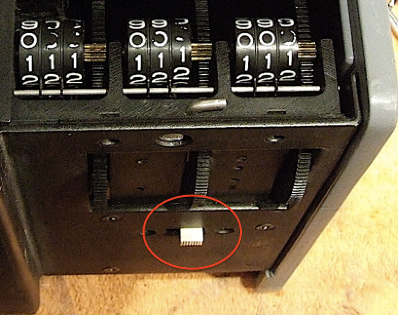

BTW, have folks found a need (for color printing) to cover the front panel (HIGH, LOW, WHITE) display? It had black masking tape over it when I got the head, but the light shield was mis-installed (blocking the fan, rather than covering the panel light), so it might have had main light leaking there, which would be enough to fog paper, I'd think.

It has been a while, but as I recall there was a switch to turn to display off.

@ic-racer You're correct, I have that switch, and it works. So, no sensible reason to need the display covered, now that I've corrected main lamp light leaking from it.
