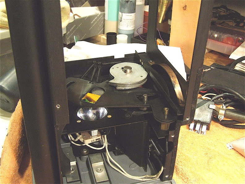

It was the older chromega head (pictured here) that had filters which needed replacing.
The newer Super Chromega II has dichroic filters. Be careful if you want to clean and inspect the mechanism. Unless you really know enlargers, tendency seems to be to re-assemble everything incorrectly and break the filters trying to clean them, based on what I have seen when repairing these.
