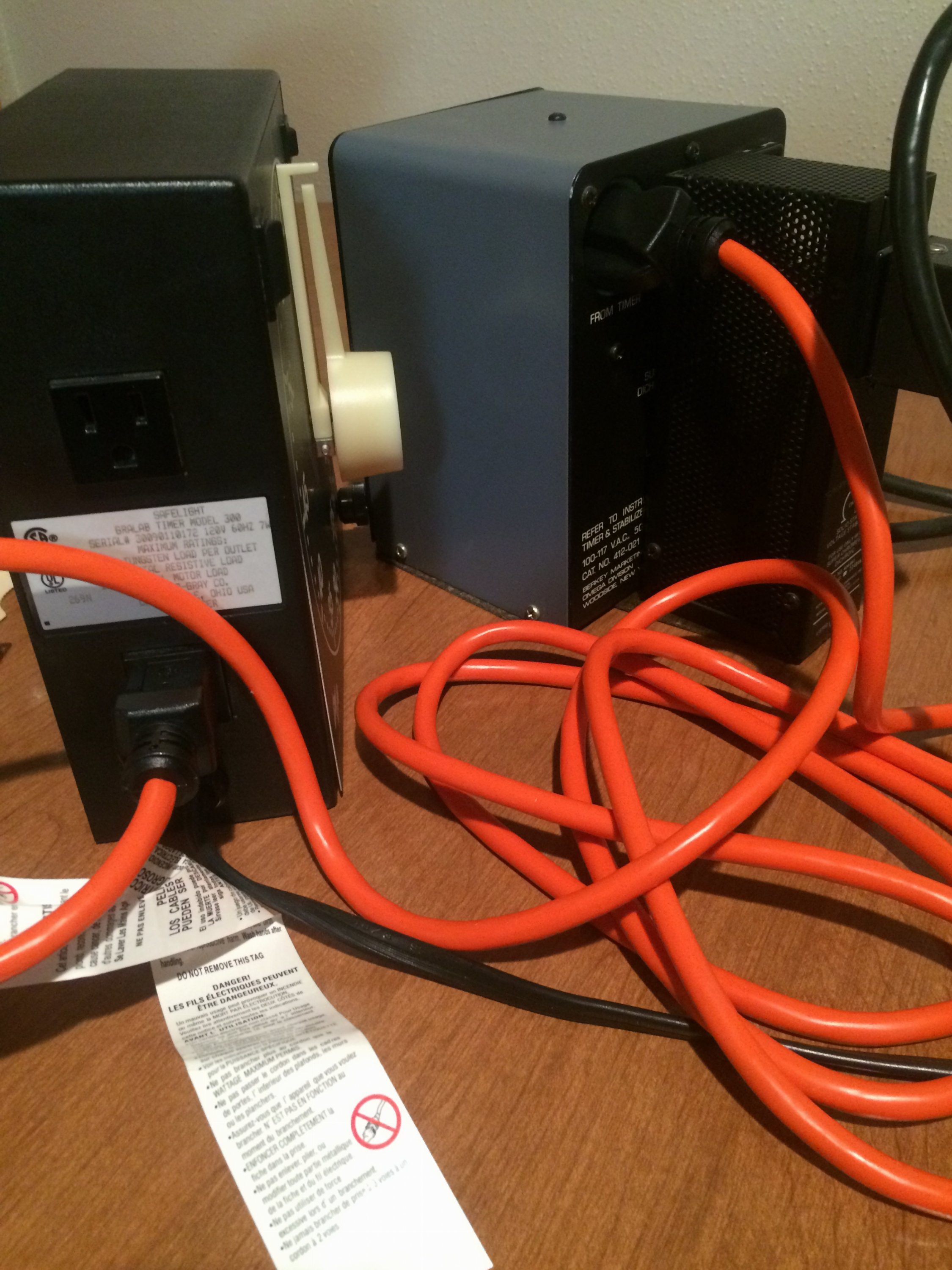

Oh, God! I'm really not sure. Could you maybe post a photo of all of your connections so that we can get a better idea of possible issues? I'm sorry about your bulbs.

With the Chromega C I believe there is only a voltage stabilizer. There is a specific plug marked for the enlarger itself. I looked online to find a separate power supply but I don't think one exists for the C.

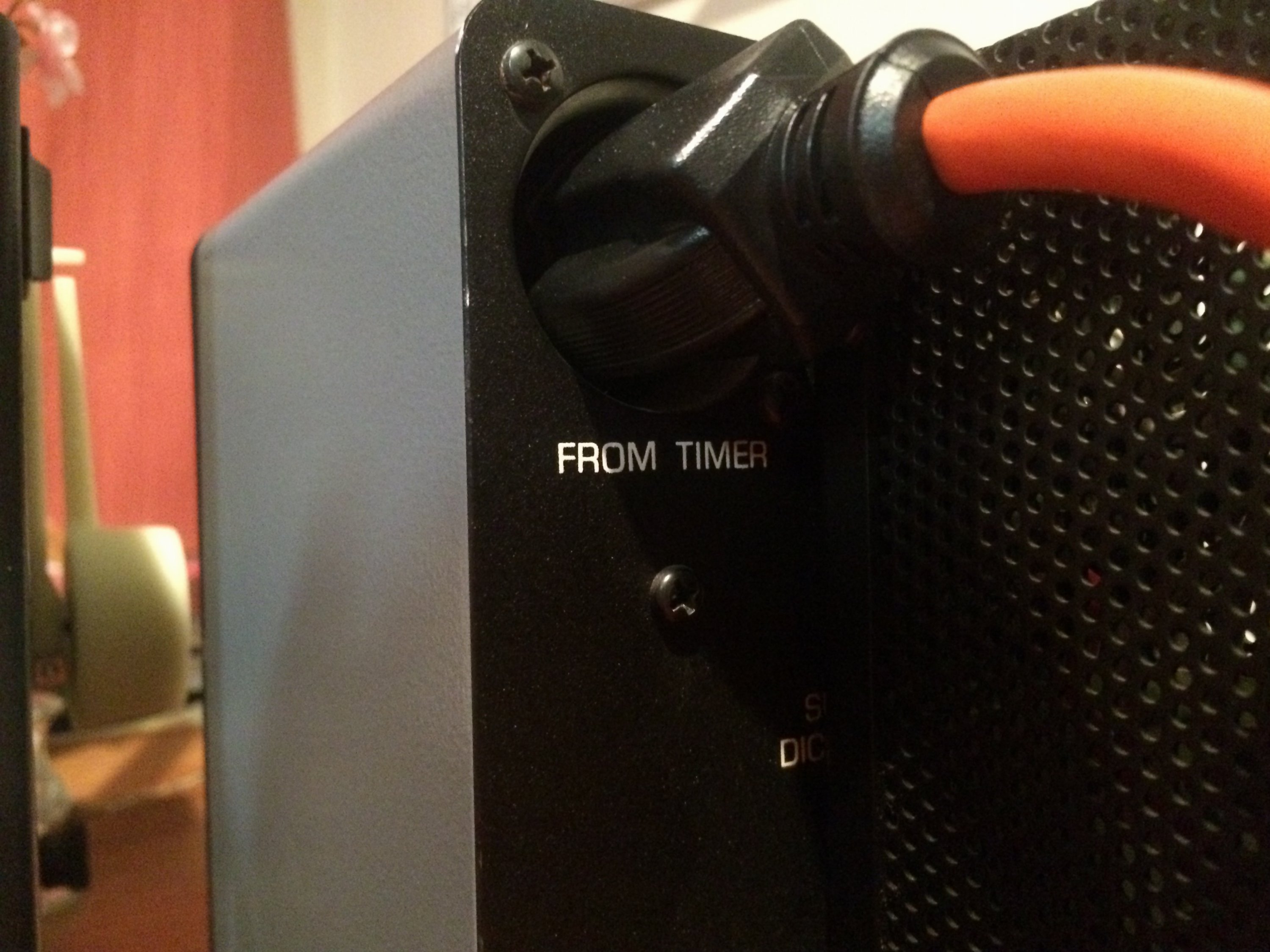

I will take a picture of the plugs when I come home from work, but they appear right compared to pictures I saw online. I plug the timer to "timer in" and extension from "timer out" to the first plug on the GraLab
