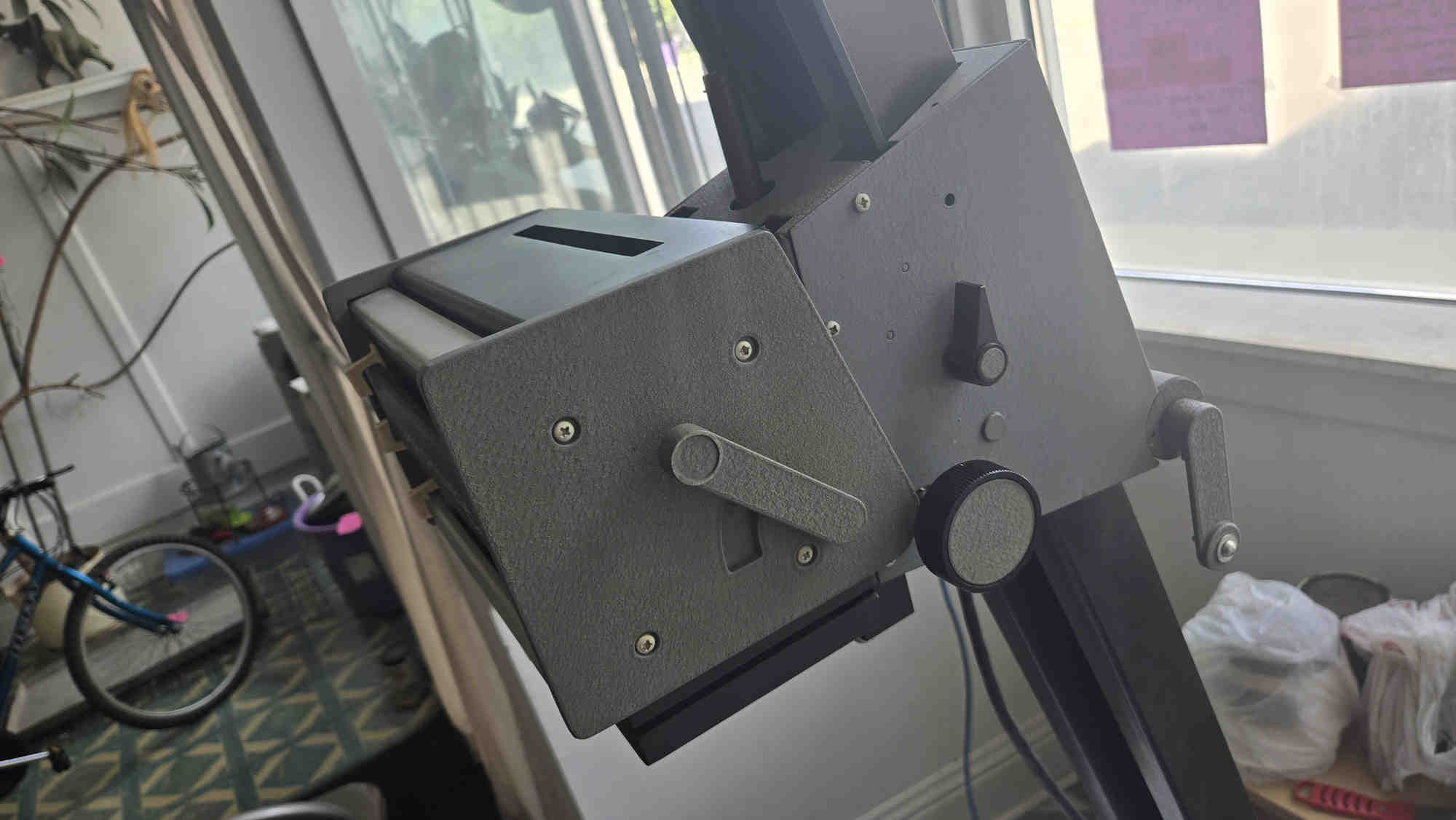

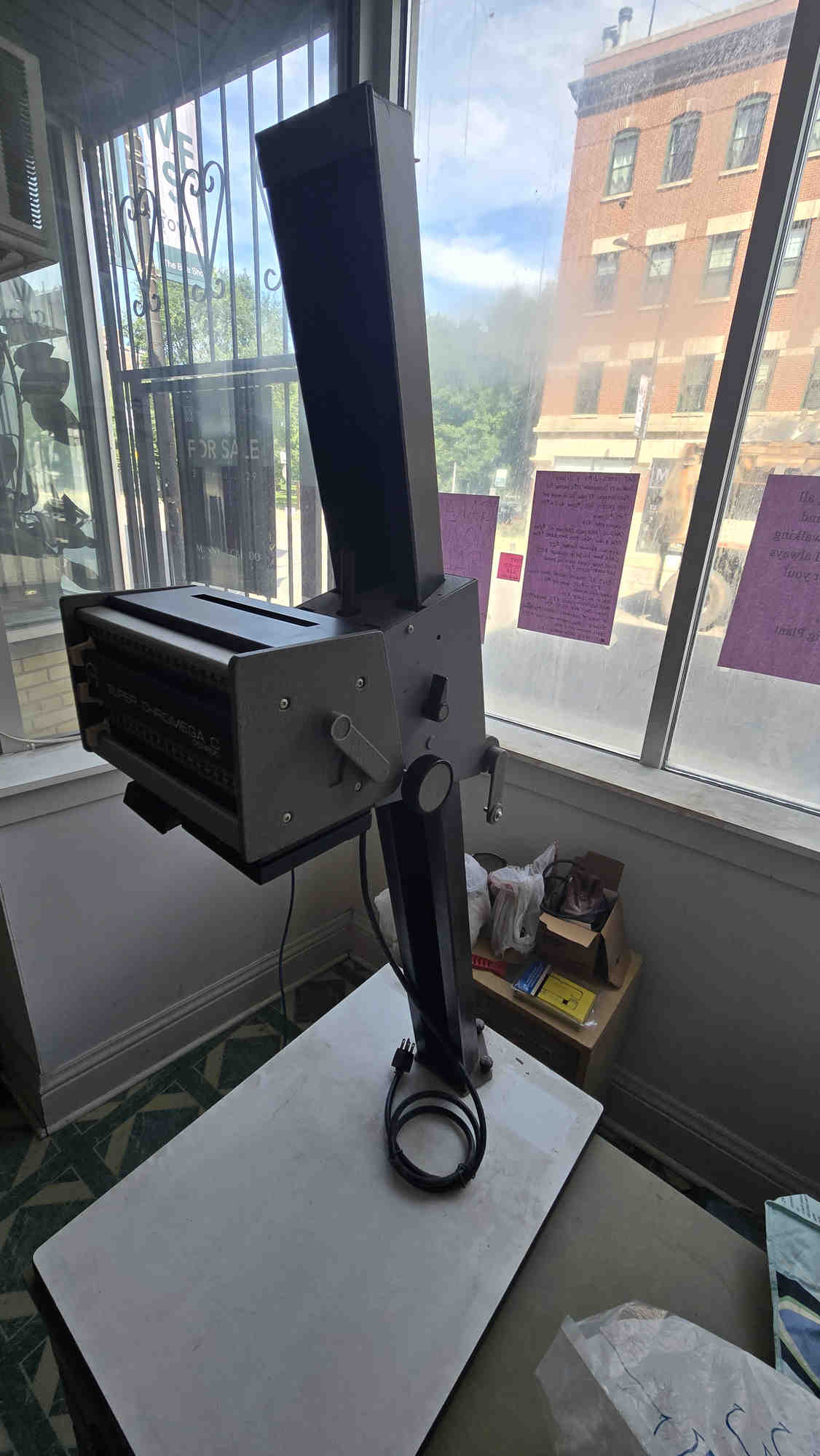

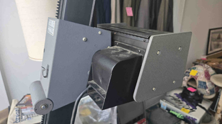

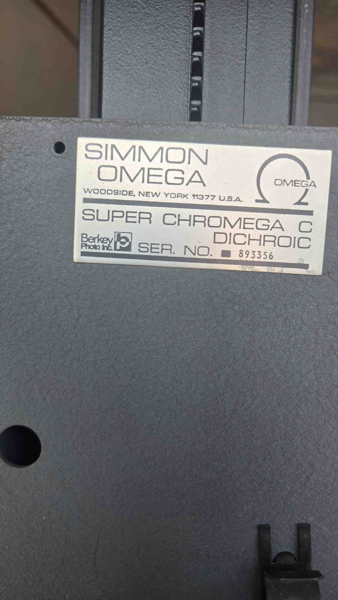

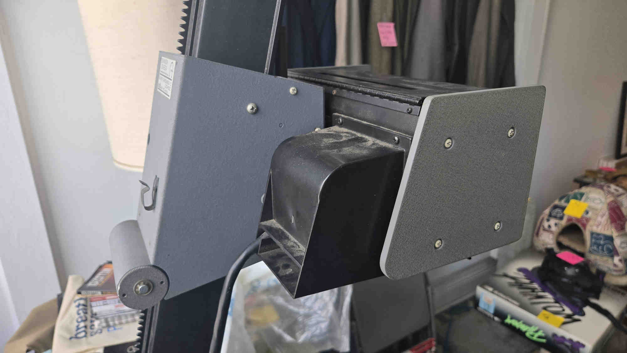

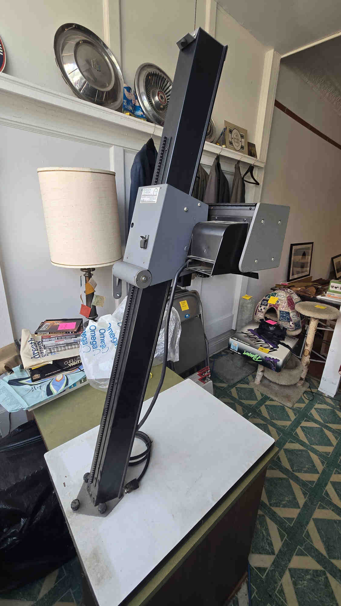

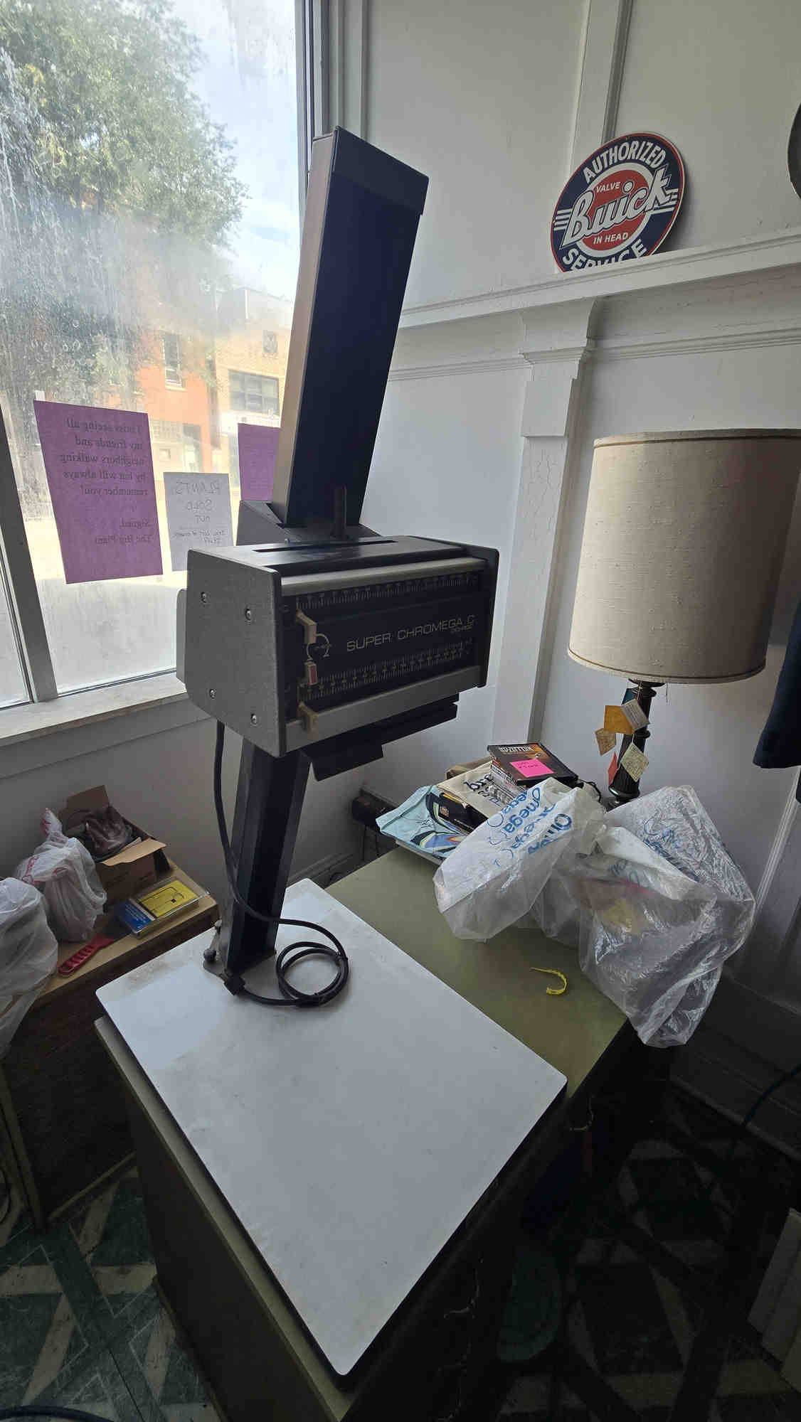

Thanks folks! Here are some photos. the serial number is on the back. I did a little research and it says the "Super Chromega C Dichroic" came on what was originally called simply the C chassis and then later called the C67. When I did a search, this totally looks like the C67, but maybe you all may know better than me, There is a wire cable in front, and when you raise the crank to lift the color head, it will go higher than in the photo, but the the cable, bunches up. It won't go any lower at all. The cable is taut, like it is locked. But starting to think the thing is jammed up and not a lock issue since I see nothing to hold the head in place. Does anyone know what the problem might be?

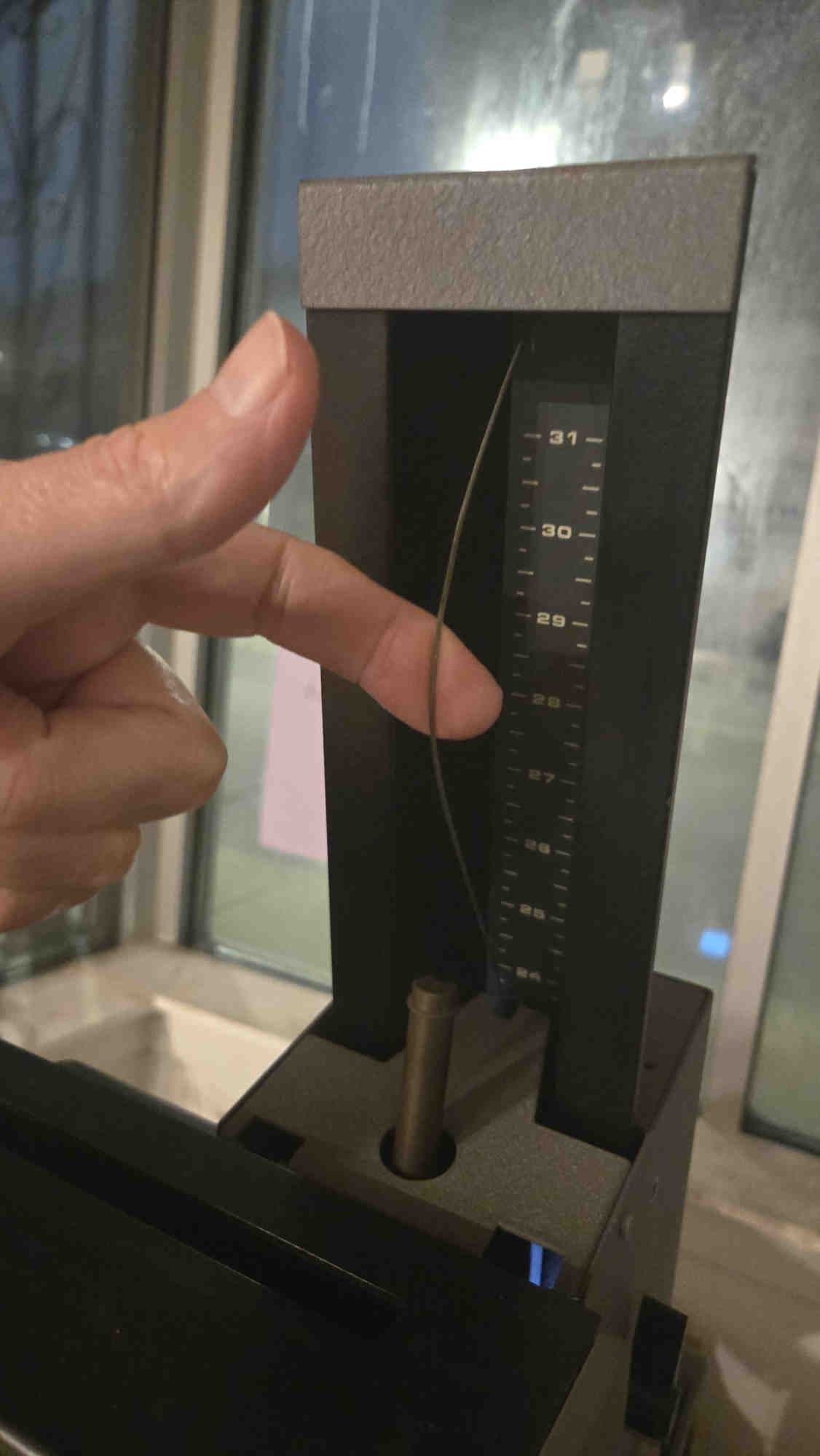

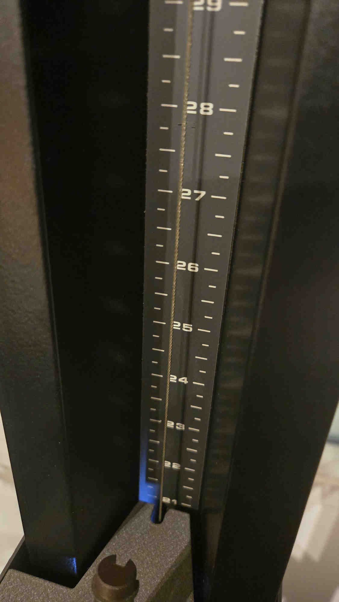

PS - And here is a close up of the cable. When I raise the crank, it gives my slack like the photo with my finger holding the cable, but won't lock higher, and when I lower it it is stuck in the position you see in the photos. It will not go lower. Any ideas?

The label "Super Chromega C Dichroic" actually refers only to an enlarger light light source - illustrated here on KHB's invaluable enlarger reference website: http://www.khbphotografix.com/omega/Chromega/ChrCDich.htm
Which chassis do you have it mounted on? That is where the lock would be found.
This KHB link may help with my question: http://www.khbphotografix.com/omega/Enlargers.htm

That cable doesn't look right to me. I would have expected a steel ribbon instead. But I haven't worked with a C67, which is what I believe you have. It probably came equipped with that head - thus the model information on the label.
I'm wondering if the cable reflects a DIY repair.
There may be someone here who has more familiarity with that model. If no one like that chimes in, I would reach out with those pictures to Kevin Brown at KHB, who in my experience is very helpful.

Well, I think the cable IS part of a recoil mechanism and the counter balance reel is behind the color head.
If you remove the color head, you can possibly gain access to it and might find the cable wrapped around something or frayed and jammed in the recoil reel.
Have you tried looking UP from the base board into the bottom of the carriage?
Just speculation...

I agree with Matt, I suspect that the balance spring that I think (maybe) should be a flat metal tape has been replaced with a wire??? Not sure.
Should be some kind of locking mechanism. Might try a light spritz of WD-40

I would vote against the metal tape,as it would obscure the height markings on the column. Al least, all the Omega springs I have seen are wide enough to cover the numbers and make the scale useless. Note the narrow notch in the carriage; never saw a metal recoil spring that slim on an enlarger.
According to the KHB site it was more of a budget enlarger as it "Essentially, it provided the same features and professional quality as the D5 enlargers but in a medium format enlarger at a lower price."
