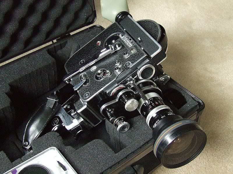

Yes, auto-exposure is nice. I have one auto-exposure camera. This H8 has auto aperture, but with the wide-angle adapter shown, the sensor is blocked somewhat.
It is nice because the pistol grip release button defeats the auto-aperture when not filming.
