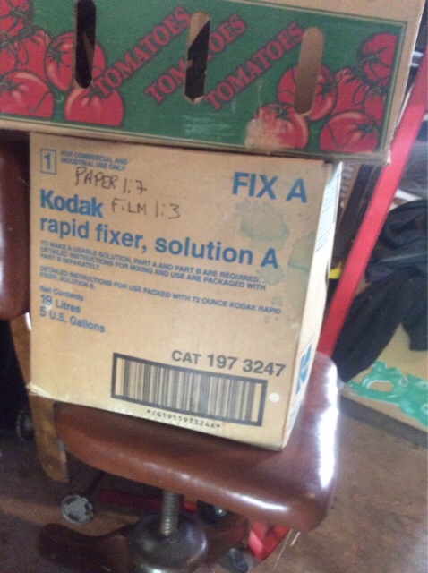

Someone gave me this giant box of Kodak fixer it is unopened but surely at least five years old. Any thoughts if it's any good?

Pour out some and check how it smells.
If it is really sulfurous, that isn't good.
Opening the box and viewing the cubitainer inside to check for sulfur deposits would also be a good idea. Just be careful to preserve as much integrity of the box as possible, because it serves as the holding frame for the cubitainer, and if the fix is okay, you will want to tape the box back up.
Also, try a clearing test on a T-grain film. If the clearing time is short, that is good.

Like the others have said: if it smells sulfurous, it is bad. If it smells sharp and acrid, it is still good. By all means test it.

Note that the box says "A" on it. This implies there is a "B" solution as well. You may only have 1/2 of the fix unless "B" is inside the "A" package. Tread carefully here. The "A" part may work just fine or it may eventually leave stains. It may be totally fine and you will have no worries at all.

Ron:
In this case the "A" solution is all you need. The "B" solution is hardener, it is optional, and in fact is sold separately when you buy the Kodak Rapid Fixer in this size of package.
I've been buying it recently in the smaller size package where the "B" solution comes with it whether you want it or not. I want it because I prefer to use it after using sepia toner on my prints, and it is difficult to obtain separately in reasonable sizes.

Thanks Matt. I am aware of that. That is why I qualified my answer. Perhaps I was too vague. Sorry and thanks.
