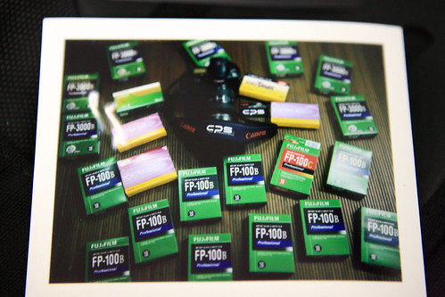

A silly little installation I made this morning, a fuji instant picture taken with a Polaroid Automatic 100 camera (which has a light leak sadly), then 'scanned' with a Canon EOS 1D pro camera. Everything in this picture says PROFESSIONAL on it but only two things are used by pros these days IMO, the EOS 1D and the CPS card...
Professional by Harry Pulley, on Flickr
For a guy who said he was done with this thread I sure have written a lot, sorry again. Time for work, rant over...
