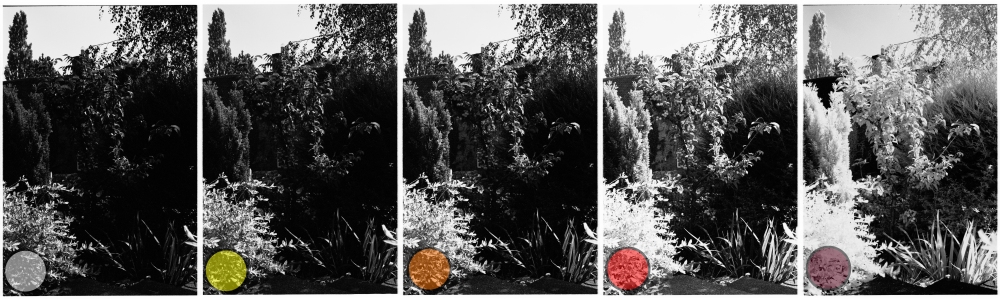

I've attached a quick illustration of what different filters do to IR film - primarialy to demo the wood effect, but interesting nonetheless. I adjusted the exposure to whatever the TTL meter read for each filter
The order is no filter, Yellow, Orange, Red, R72

I've attached a quick illustration of what different filters do to IR film - primarily to demo the wood effect, but interesting nonetheless. I adjusted the exposure to whatever the TTL meter read for each filter
That's an excellent comparison Ben, but what film is featured?
ben-s
Jul 12, 2006
444
Nottingham,
I missed that one :wink:
In this case, MACO 820C, 400 ISO.
The results you get from HIE are pretty similar too, but you usually get the characteristic "glow" around things from no Antihalation layer.
Shot in a Canon EOS 500, 50mm lens.
If my slightly inebriated memory serves me correctly, f/8, Tv ranging from about 1/100th to 10 secs.
