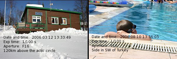

Both images below taken with the same camera, both at the same iso, same shutterspeed and aperture. The left in mars above the arctic circle in sweden, the right in august in the south west of Turkey. So, the sunny 16 do work in real bright sunny weather, no matter where on this globe. And to answer the initial qustion. I would err on the over-exp. side since you are using negative film. I usually rate color 160 film at 125.
