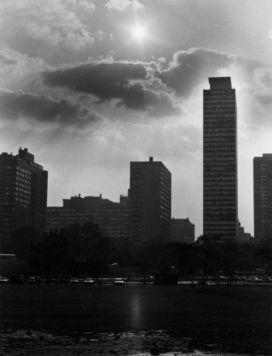

It stands to reason that if you can capture sunstars with digital that may be you can also get sun stars with B&W film but i havent seen a image with a sun stare in it . can film not record one ? cant find any info on this >

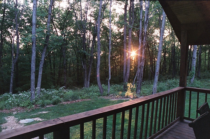

Do you mean something like this?
It's not B&W, but it is film, so yes, film is capable of it.
I forget the details and even the film (Kodak or Fuji), but it's 35mm developed and printed (and scanned) by a drug-store minilab. Also, I'm not sure how I did it. Obviously I used a small aperture, but I basically take snapshots as memories, and any good or interesting photo is mostly accidental.
