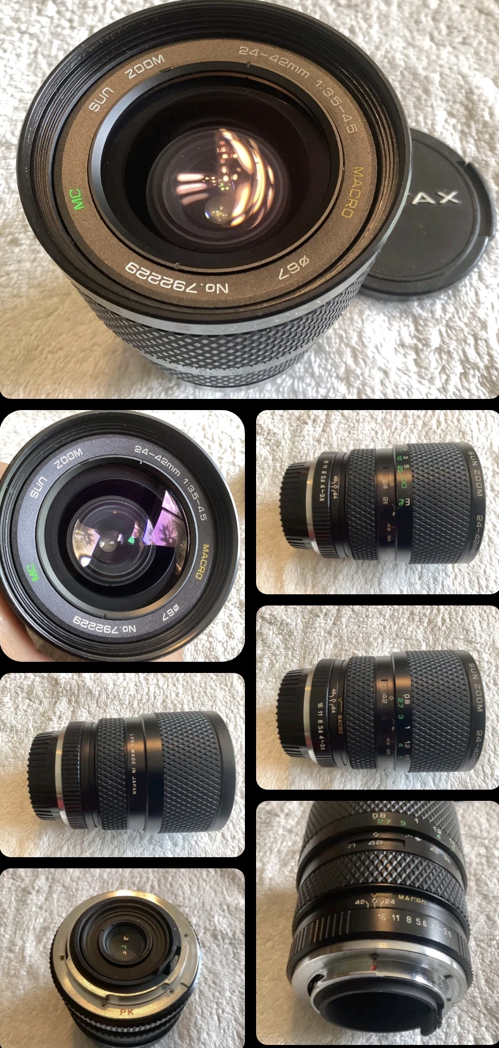

I found this lens on eBay and the focal length intrigued me so I started researching it. I found nothing whatsoever. There are reviews on Pentax Forums for the 24-40mm f3.5 but nothing for the 24-42. I suspect it was the replacement for the 24-40 as the lettering looks to be a bit more 80s. Does anyone know anything about it? Is it a marvel or a monster? I have never drawn such a complete blank before so any light would be gratefully recieved

these are the original images from the listing, if that helps
OK, the lens is here i t is wierdly wonderful and wonderfully weird. There are three rings, aperture, focal length and focus. When you are at 42mm you can click the ring into macro mode where you get 1:6, 1:4 & 1:3. All of the zooming happens inside the camera body so it never extends. I have it on my KP and it looks like it will be pretty capable if soft in the corners, which I am expecting. It is the same size and weight as my Pentax 20-40mm limited, so, not excessive. I rather think it may turn out to be a hidden gem.
