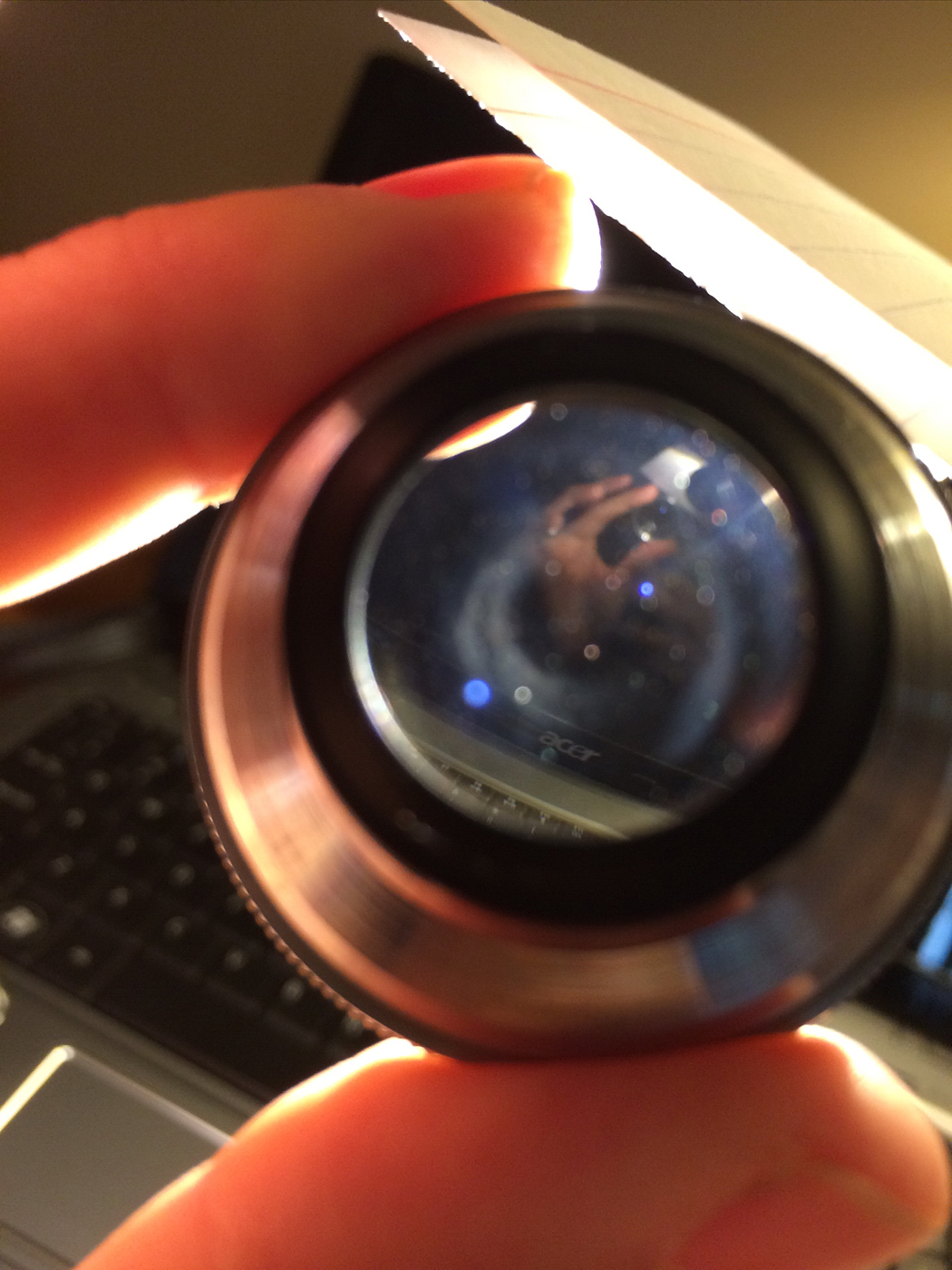

The 1949 Summitar (s/n 679xxx) I bought has some slight internal hazing. It is apparent on photos taken with brght sources of light in the background. On close examination using a light I can see the haze. I want to get this cleaned. I've narrowed down my service choices to Youxin Ye, Steve's Camera, and DAG and am leaning toward DAG but before I throw any money at it I'd like to know the success rate for this type of work on later Summitars. For anyone that has had this done, did it work and were you satisfied?

Well, in the time it has taken to post this i found a site that explained Summitar disassembly ( http://justinlow.com/articles/repair-leica-summitar ) and have cleaned the offending internal element of my lens. That was easy.....
Before:
After:
Thank you for the responses but I think I will just save my money for now. Hopefully all is well with the lens. It wasn't bad before unless pointed at the light.
