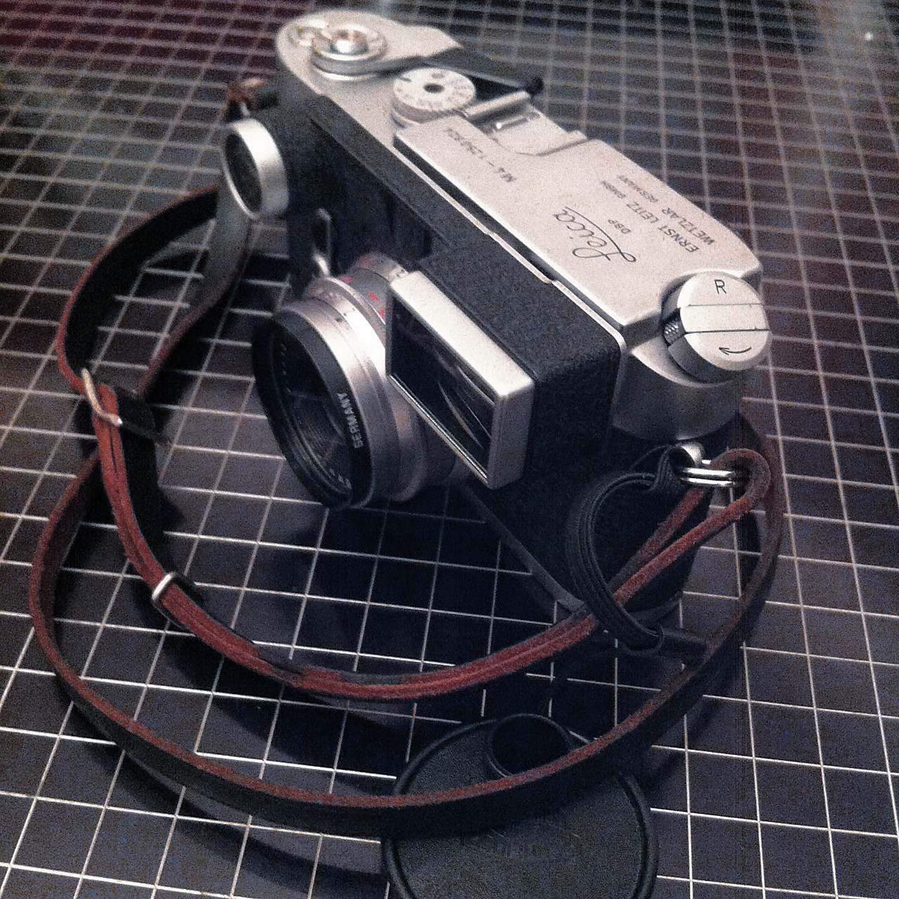

blind_sparks
Jun 11, 2008
118
Milwaukee, W
This is the set-up that I use on my M4 - I love it. I used to use an Canon 35 on my M2 and was always having to move my eye around the finder to get an idea of exact framing. In my opinion the added bulk is nothing to get too worried about - The finder does 'ghost' in certain conditions, and one can see the 'tunnel' of the finder optics extending into the viewfinder area. Other than those two things, it's my favorite combination. The 8-element Summicron is a real gem, finder optics or not!
