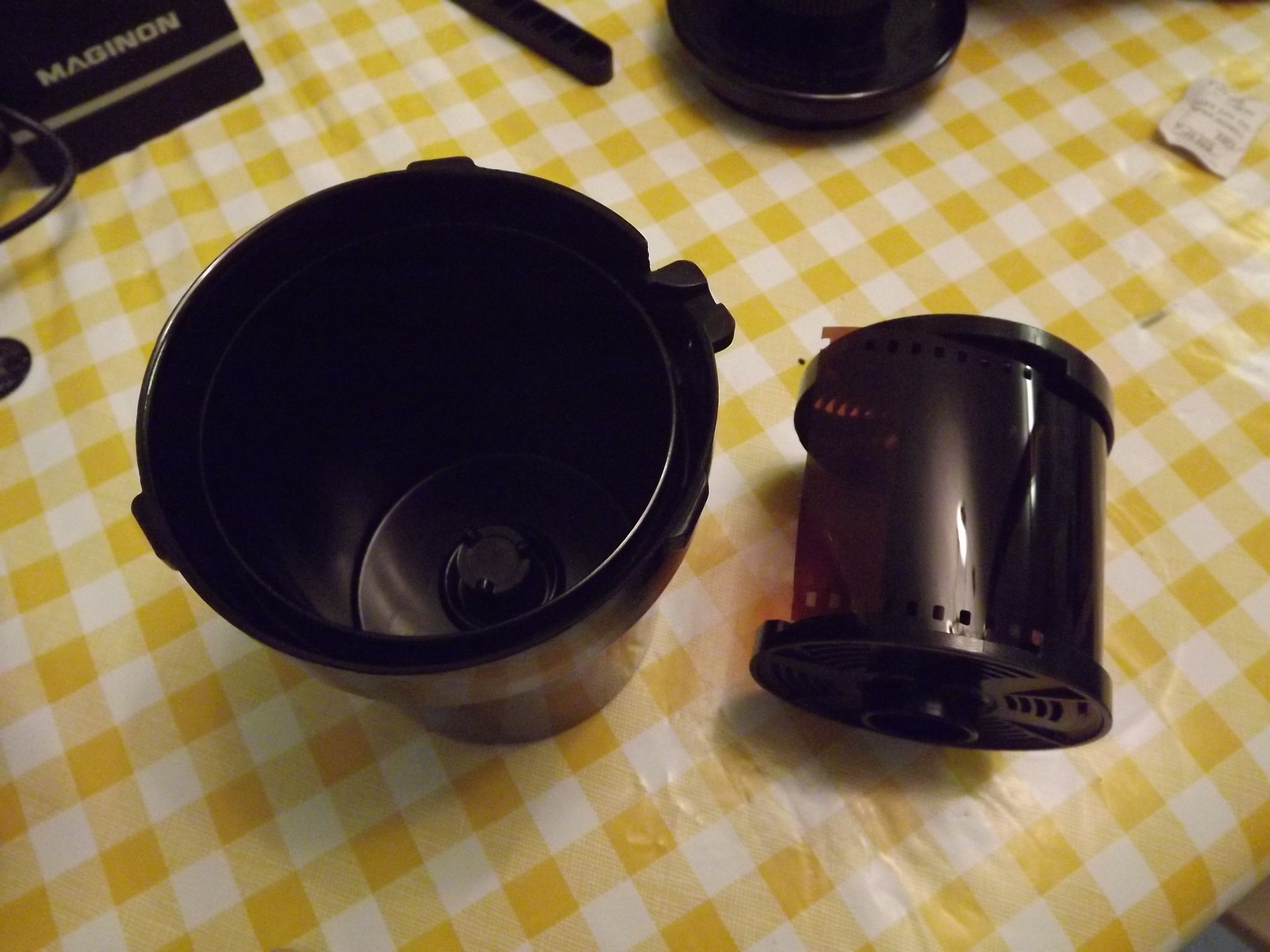

I have tried to use an old patterson 616 bakelite tank for developing 65mm film. I ran into a lot of problems. With some faffing about i managed to get the film on the spindle but, when it came to the prebath backing removal step it all fell over as the tank is very small and the washes do not clear the carbon backing. Any one know of a way to modify a more modern paterson tank?.

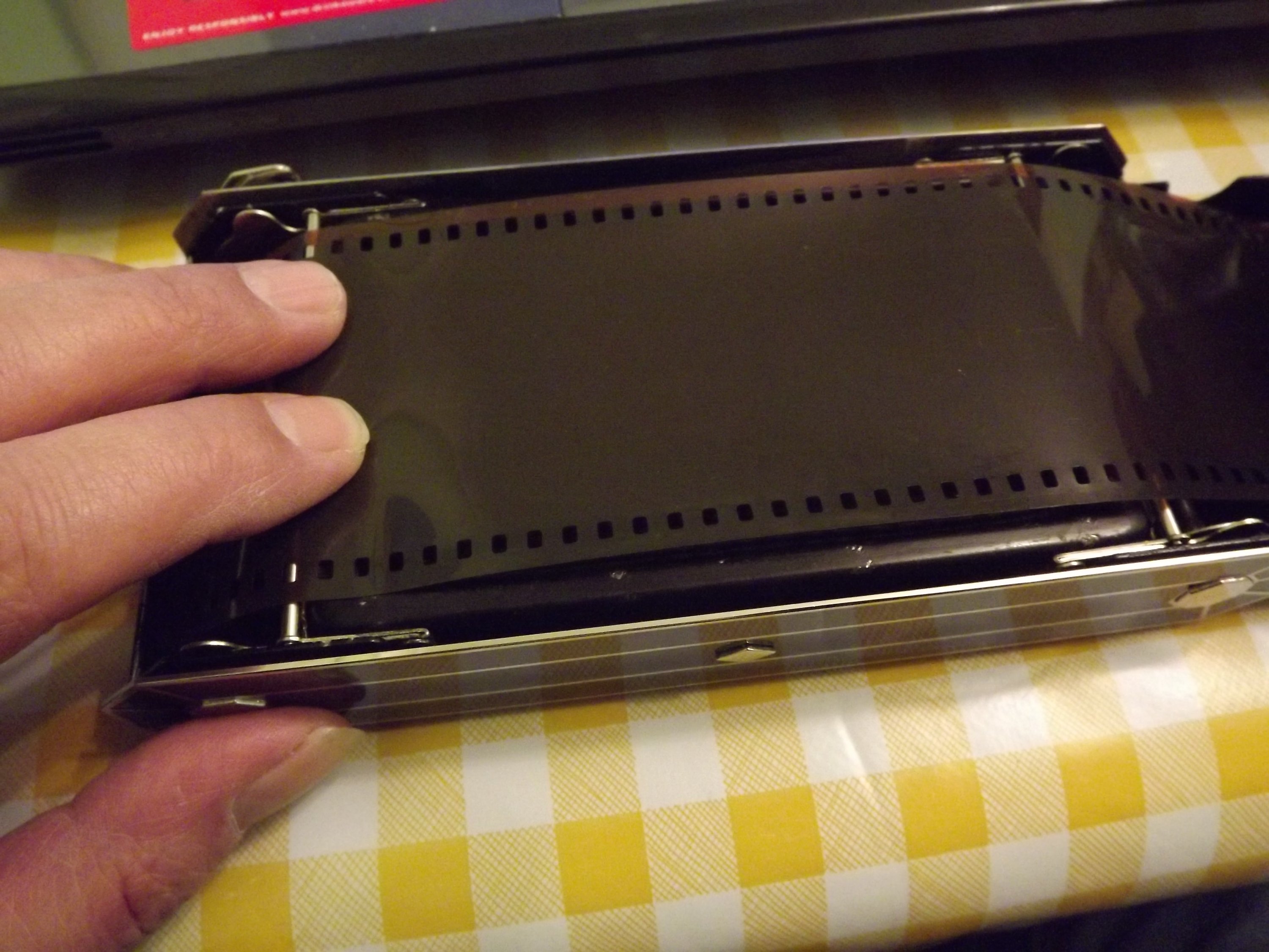

Its 65mm wide film with perfs. I have an old Kodak 616 folding camera 1930's. I use the old 616 spools and backing paper to reroll the film.

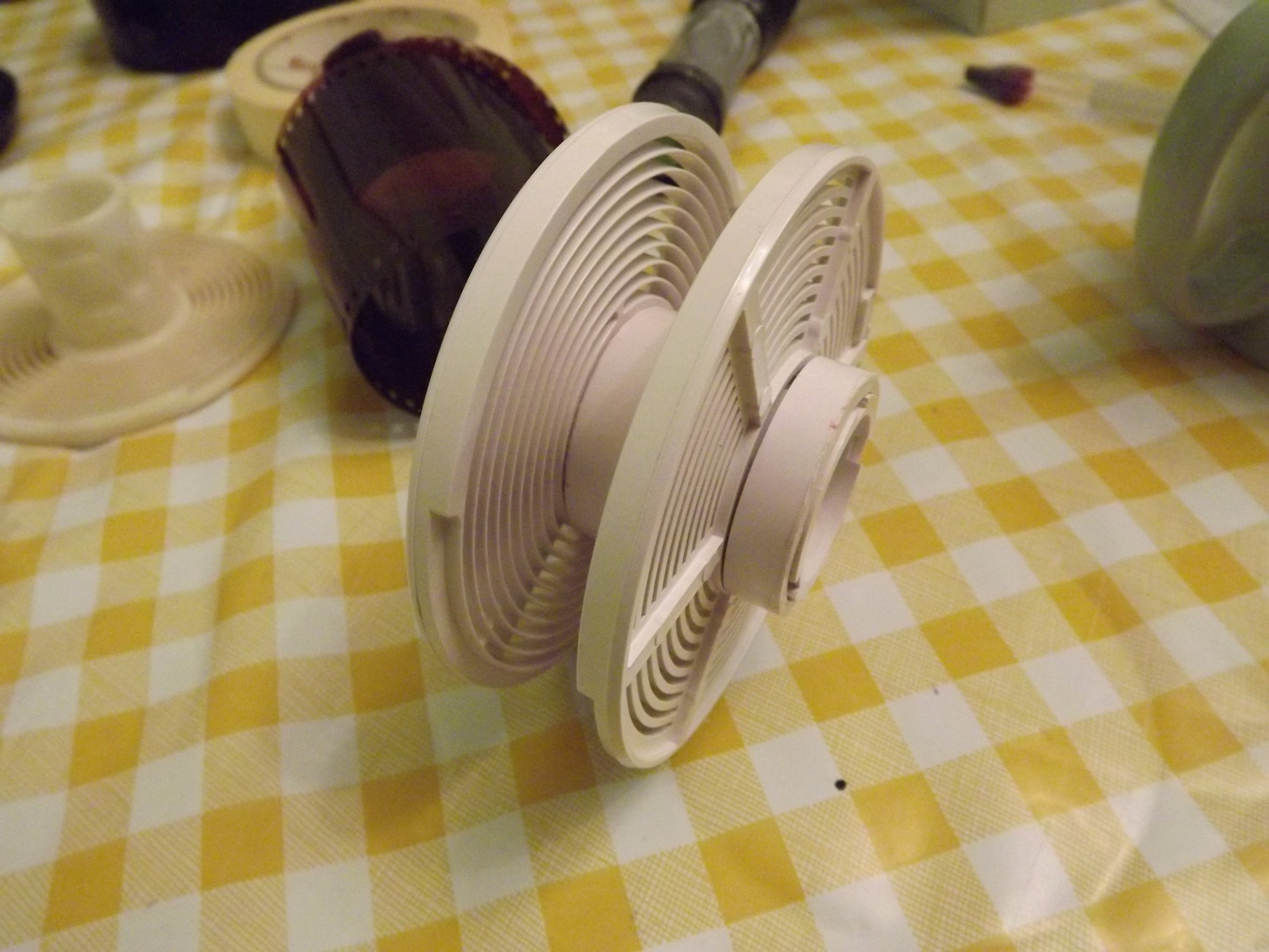

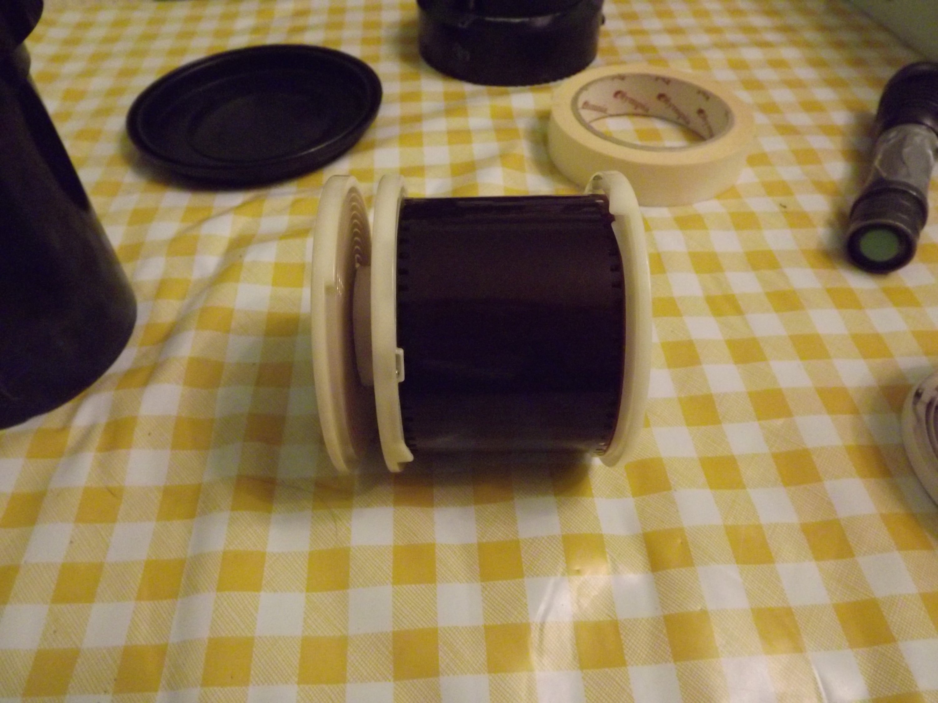

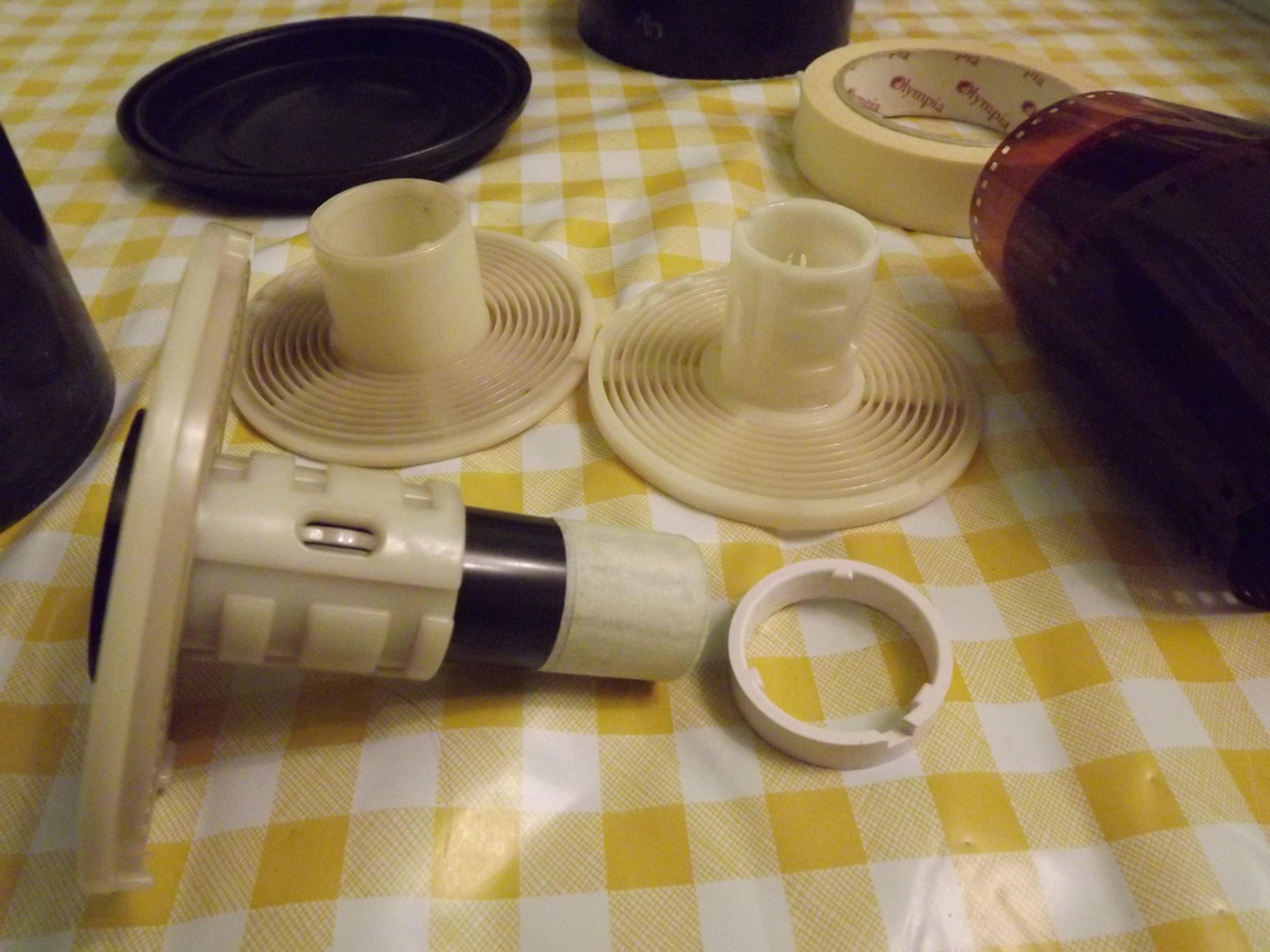

I found an old spool that I converted to take APS film (see pics). I used the collar as a spacer, that keeps the bottom reel in place, then I wound some masking tape around the spindle to help keep the top reel in place. Its not perfect but the film does seem to stay in the grooves when its in the tank, yet to test that with the wild agitation that is needed to remove the remjet backing.
