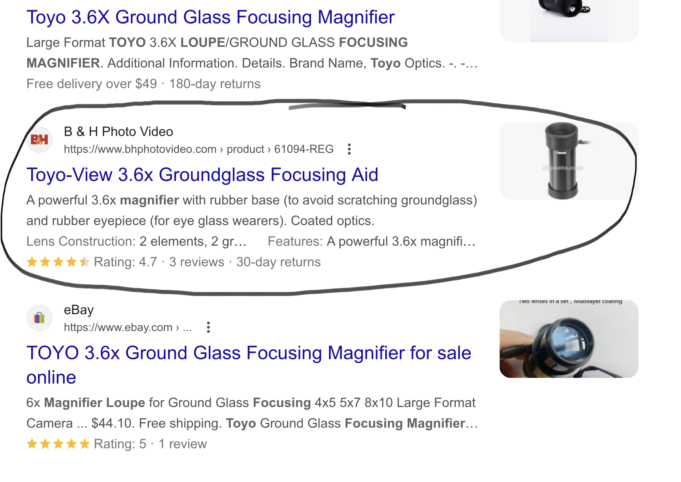

I have a very bright fresnel type screen with etched and clear cross hairs I've started using with my camera but because there is no prism at the center, I want to be sure my focus is right on.
Can anyone share their experiences with loops for the Hasselblad structure and, possible recommendations?

I don't use a loupe or even the waist level finder with my Hasselblad, but Toyo made a nice focusing magnifer that would probably work. Wista, and others, also made something similar.

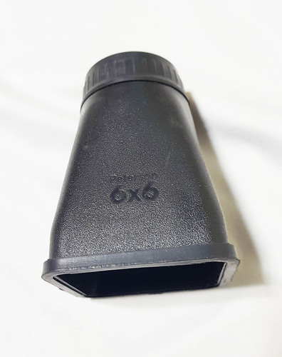

Keep your eye out for a used Peterson 6x6 loupe. When available new, the eyepiece came with a clear skirt and a black skirt, and the black skirt would be ideal for use as the magnifier of a MF focus screen. There were a variety of rubber base pieces, like a 135 format cutout and a 6x6 frame cutout; and the 6x6 base rubber had an outer dimension of 61mm and and ID of about 53mm. Unfortunately these do not appear to be available new any longer; I bought mine over 30 years ago.
Here was one on the used market

To your specific question though, I had tried at one point to use a loupe with my Hasselblads and did not like it.
1-unless you get one that will cover the whole focus screen, you won’t be able to see the edges, only the center
2-you have to stay with a lower magnifcation. Too much will only amplify the texture of your screen, and make it harder to judge sharpness. 5x would be max, 3-4 maybe the sweet spot
3-the waist level finder is not that big at the top, so getting a loupe to fit through there is going to be tough. Mine did not fit, and I was going to have to remove the finder to get the loupe onto the focus screen. Not only was that process itself a problem, but once the finder was off now stray light was coming into the focus area as well. The term “one armed paper hanger” comes to mind.
4-A good split image screen is selling for $400-500 these days. They scratch easily. Putting something like like a loupe onto and off of that surface is going to damage it, hindering the sharpness thereafter
5-I have seen those chimney finders for $100 or less. I haven’t looked at them in detail, meaning I’m not sure the price of a nice quality one, but to get a good loupe isn’t free.
I still stand by my original answer to you, I just skipped all of the detail in this post and cut to the chase.
Good luck with your search. I ended up biting the bullet and buying split image screens for all of my bodies because I couldn’t focus reliably with the others.
