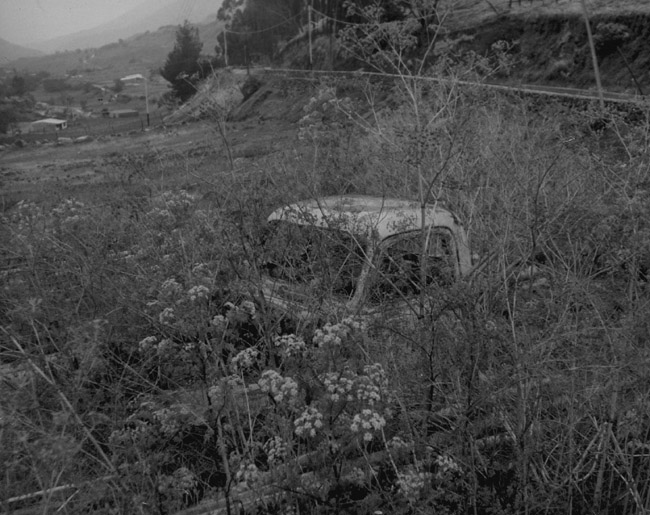

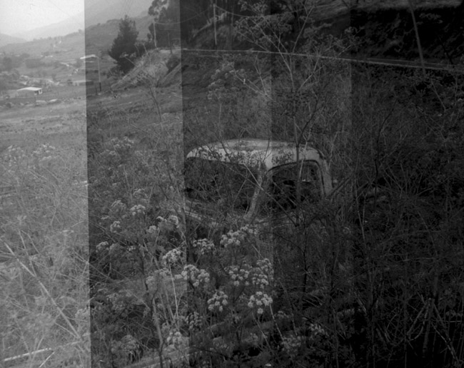

Just use Ortho film from any of the suppliers. You will need to waste a few cut up strips testing to see how it reacts. Here are a couple of examples, one of a test strip and the other the final interpositive. You want a flat image. There are many ways to do it.
