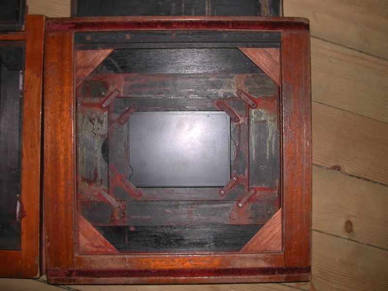

To start at the other end of the camera, I have a wet/dry plate holder back for up to 18x24cm plates. You can tell it's been used for wet plates from the chemical stains, which the d*g*toy has somehow accentuated...
