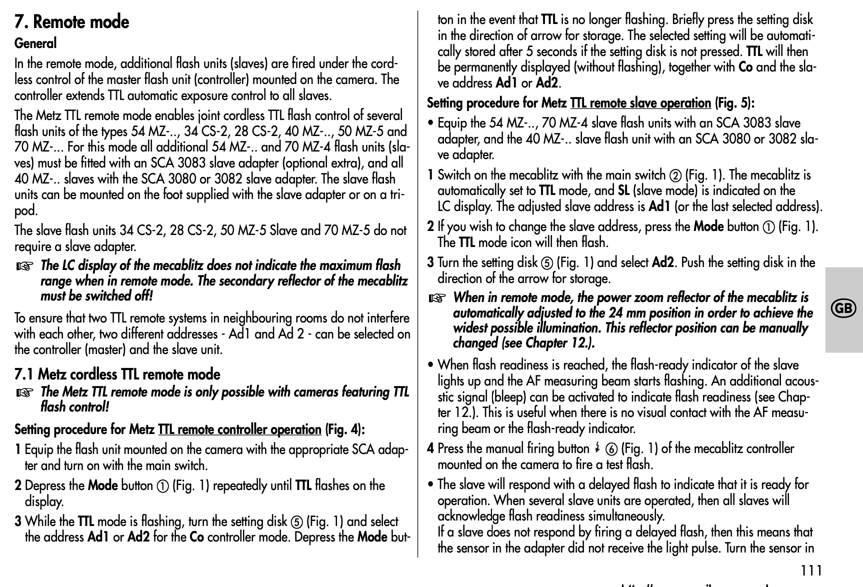

Have you tried this:

The Rollei 6008 only works in auto mode with the Metz and its adapter, and probably not remote, only when mounted to the hot shoe.
This seems to be in conflict with the Metz instruction manual (which ic-racer pasted an image of earlier in this thread).
