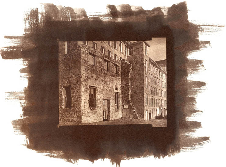

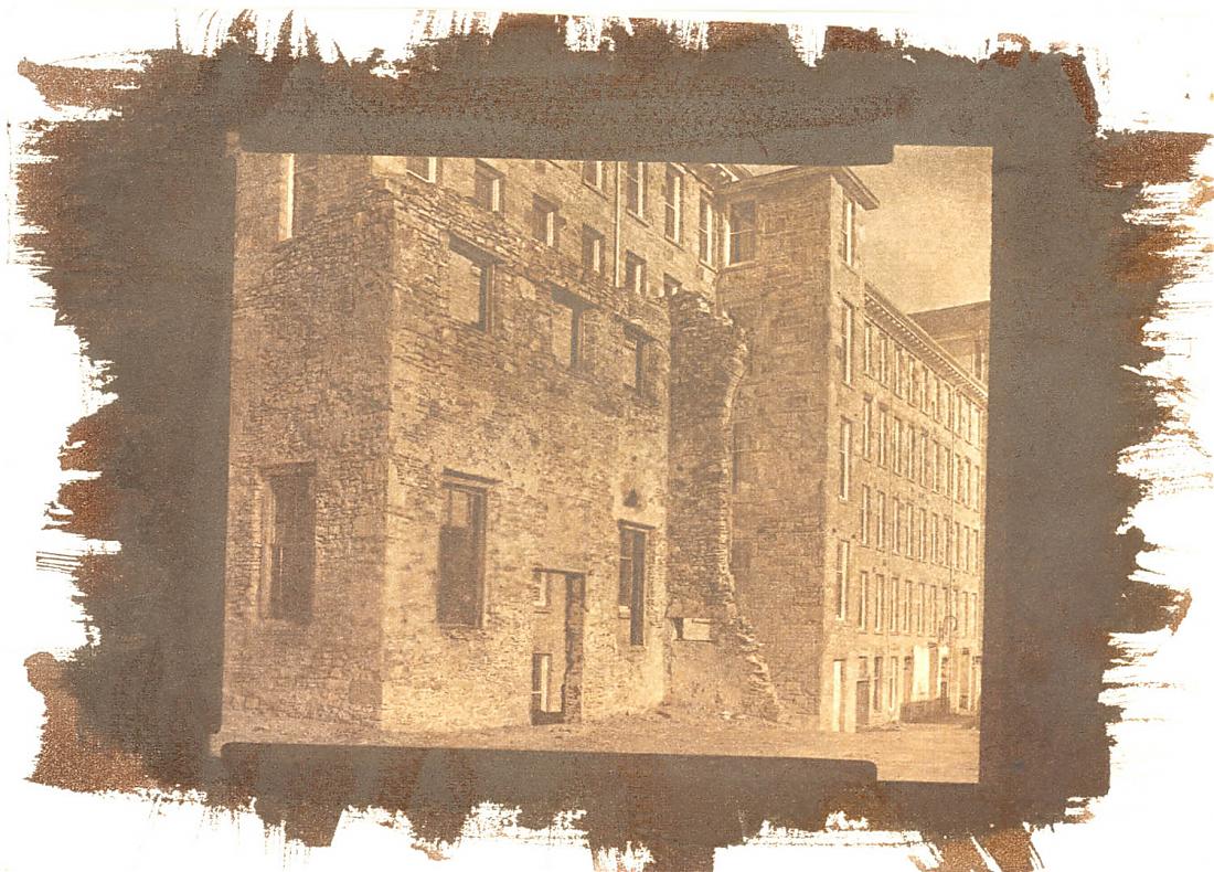

the pictue of the wheels i did 2 weeks ago. i am getting better shadow and highlight details since switching to arches platine.
the shot of the building is way better with the new paper. my newest question is why is the wheel photo richer than the building? i had made a building photo when i did the wheel photo but i gave it away. i just made the building photo again today and it is not as rich. i am using the same sensitizer and paper and exposure times (with the sun). what could it be?

oh! the photos may help.....
