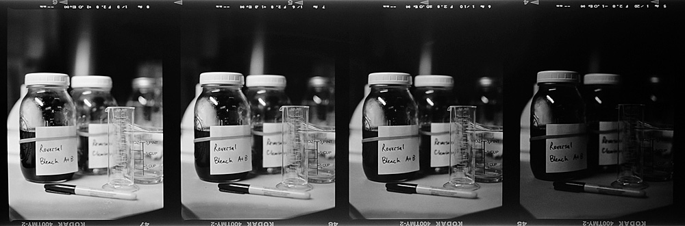

I wanted to share my success with the Photographer's Formulary TMax reversal kit. One problem I had was finding out at what EI I should shoot my film, so I shot and developed a test roll of TMY-2 with shots at 100, 200, 400, and 800.
I followed the directions in the kit exactly as stated, and made no changes. I used my normal process with Kodak stop/fix/Photo-flo for the end processing.
The image below is a snapshot of the results (as the film is hanging to dry), back lit with my soft box. Looking at these results, I am shooting my next roll of TMY-2 at EI 160.

The contrast looks good.

Thanks for the post. I've been thinking about the reversal kit for awhile now but always went elsewhere. The frames apparently run right to left, so the ISO 100 frame is far right? What speed was the film, 400?
Thanks Bruce.
Wayne, the film speed is 400. I included the frame edges where you can see the exposure compensation I used on each frame - looking from left to right in the picture, the EI would be 100 (+2 exposure compensation), 200 (+1 e.c.), 400, and 800 (-1 e.c.).

Yeah that's right it's reversal so an overexposed frame will come out brighter, duh. Anyways, 200 looks good to me, although I didn't see the lighting like you did. Thanks.
