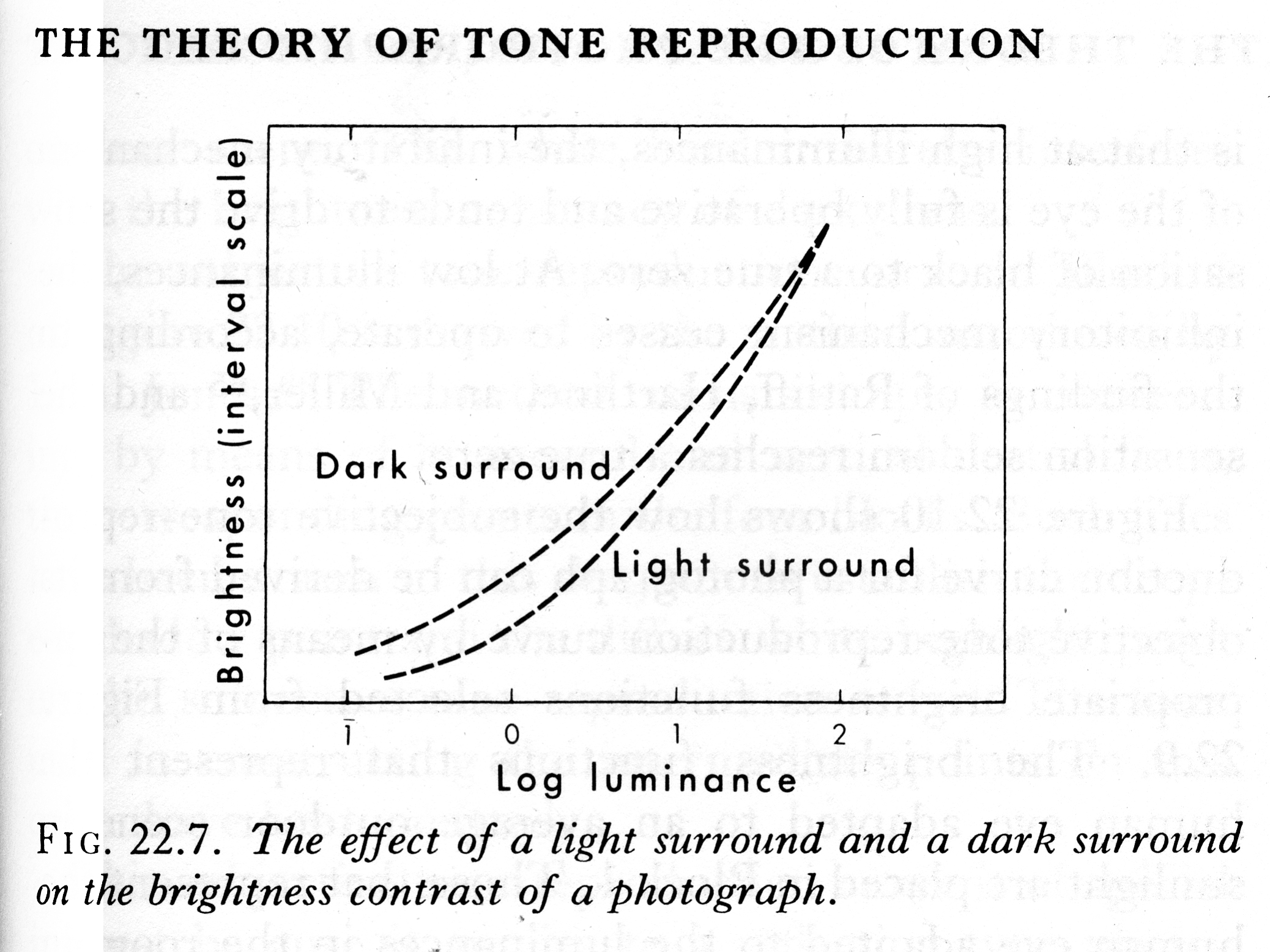

The following graph shows the effects of light and dark surround on the perception of brightness in a photograph. Not only would this apply to what surrounds the entire photograph, like a matte or wall, but how the tones respond to other tones within the photograph itself as the second set of examples illustrates.

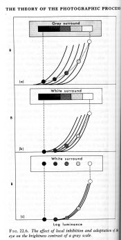

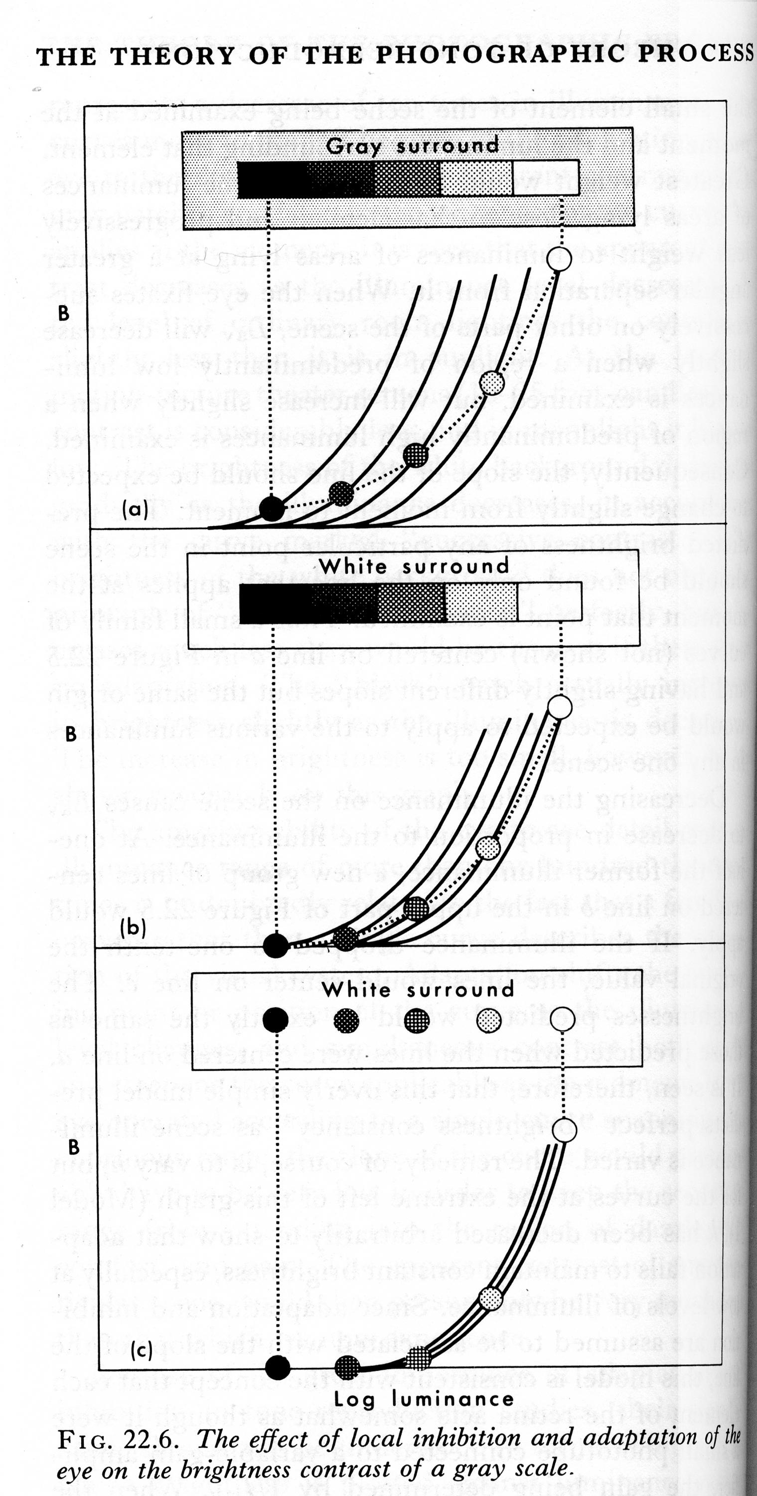

This last example illustrates local inhibition and adaptation of the eye on a gray scale. The x-axis is luminance and the y-axis is brightness. The first graph is of the gray scale surrounded by a medium gray background. The second example is of the gray scale surrounded with a white background. The white surround makes the gray scale appear darker, increases the apparent contrast of the three lightest steps and decreases the contrast of the two darkest steps. The third has the gray scale with a white background as well as white separating each step which shows an even greater effect than the second example.
