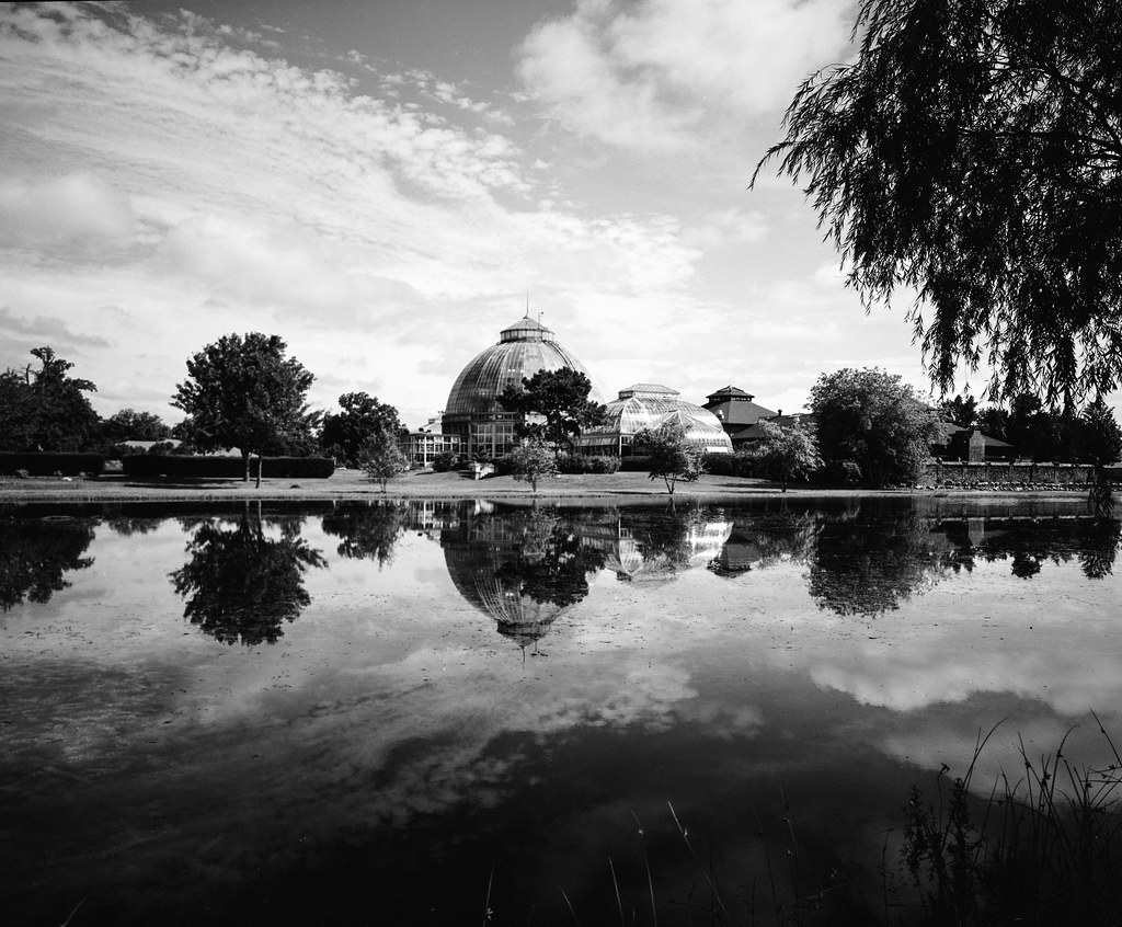

RattyMouse
RattyMouse
Oct 18, 2011
6,045
Ann Arbor, Mi
Here we go....one example.
