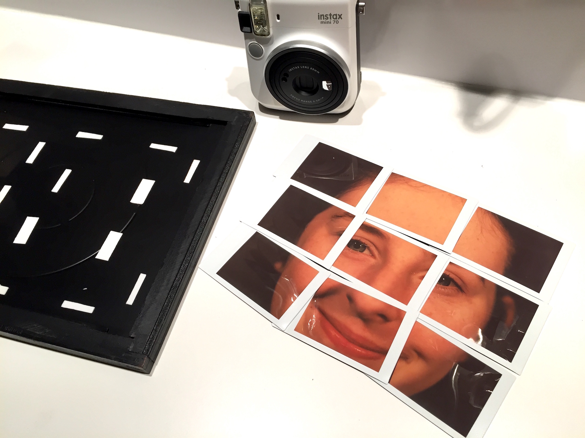

You couldn't just frame with the ground glass? As mentioned, the instax film can be attached to a 4x5 or 8x10 film holder.
