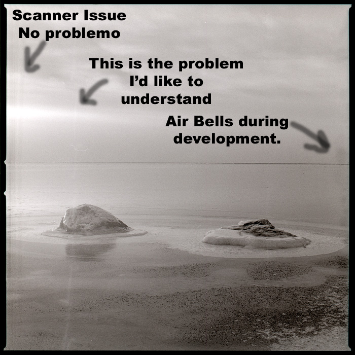

I'm getting really fricken sick of this. Every time, without failure, that I take a photo trip somewhere; every time that I get a chance to just be with myself and my camera and I can really create - I get film developing problems.
Granted, in the past I have used expired film, etc, but this time I was armed to the teeth with fresh Tri-X and Plus-X film. Camera checked out days before with both film backs, no problems. None.
So then I get back from a trip to Lake Superior, 19 rolls later, and i end up with uneven development issues, negatives dense like bulletproof kevlar vests...
But this one wins the grand slam - some kind of line that has higher density than the surrounding areas that goes the entire length of the film, about 1/3" or so from the film edge. It's a tad irregular. It's on the last three rolls I have processed from a certain place where I had gone through and tested a different developer for the film, HC-110, before I processed the film. I exposed an entire roll and tested it, then I exposed one more and tested it too, just to be sure. Squeaky clean negatives.
Then I develop the stuff from the trip exactly the same way - 8 minutes at 1+50 from syrup, agitate every 30 seconds for 5 seconds. 70*F water. The densities of the negs are great. Please look at the neg and see if you can identify what that line is.
I am so effing sick of having these problems I'm thinking about just hanging up my hat and quitting this. I am so frustrated I am ready to take my equipment and just give it away and walk away. Fed up.
I mix the chemicals with either distilled water or boiled tap water that's been cooled off, or a mixture thereof. Stop bath is fresh (indicator) and fix clears a film strip in 30 seconds.
I have tried all kinds of chemistry, distilled or boiled water, different agitation. When I cured the uneven development problem, it's automatic that another one would show up. Like fucking clock work.
I'm at my wits end. Don't know what to do.
Sorry, I can feel your pain but probably can't help much. It's odd as it's kind of a curved line, and is that other shorter line near it at the bottom part of the same problem?
Yes, the little line is the same problem for sure.
Thanks.

I could be completely off base , but from your other post I have thought the marks to be a pinch roller or something very similar. Something in the camera. Maybe you take a set of pictures in a row and a roller binds causing the problem.
It it is fairly repeatable I would suggest having someone else develop a roll, I'll volunteer. Try several sources. You need to isolate is it processing or elsewhere.

Boiling water will de-gas it. Like David I've had problems with air bells in the developer. A problem that persists, but gets decimated by boiling the water and then cooling it off again.
I processed three rolls of 35mm film just hours prior to the important stuff, and they came out perfect, without a hint of a problem.
I do fill the tank to the rim. 1,700ml, which leaves a little bit of room on top to agitate.

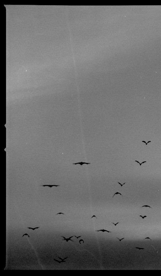

It is hard to see really clearly from your scan, but the more I looked at it the more I thought it looked like the problems I used to have. I just went and dug out and quickly scanned an old neg which exhibits the problem. I attach the relevant part of the scan here (please excuse dust spots). Looks pretty similar, don't you reckon?
These marks were caused by my wetting agent solution as the film was hanging to dry. There is the long straight line running right down the neg (and which continues in a straight line right down the whole strip) plus the smaller tide-mark pattern on the bottom of the neg. I think the problem is generally too much Flo, although I think too little can also cause problems. What is exactly the right amount seems to vary depending upon water supply. So if the water supply/quality changes, one's usual Flo quantity may start to cause problems. As I said in my previous post above, putting a splash of Isopropyl Alcohol in the wetting agent solution with only a very small amount of Flo seems to fix the problem.
Again, I don't know if this is your problem, but it at least looks like a contender... Don't smash up your gear yet!
If you hold the negs up to a light you can see if it's something that's dried on them.
You do presoak, don't you...please tell me you do.
The sort of drying marks I am talking about are effectively in the emulsion. You cannot really see anything dried on the surface of the emulsion, although occasionally there are other drying marks on the backing that can be cleaned off. The marks in the emulsion cannot be removed.
I found the following in a book by Eddie Ephraums (Creative Elements):
"The surface tension won't be broken if too little wetting agent is added. Too much agent and the water tends to become slightly viscous, drying in rivulets that leave longitudinal drying marks within the emulsion and greasy-looking streaks on the film backing. The latter can be polished off - gently - with a cotton bud or similar."

Ian, that's interesting, and pretty much similar if not identical to what I'm seeing.
What I have been doing with my film lately (for the past couple of months at least) is to soak it overnight in distilled water. I make sure to agitate out all of the air bubbles, then do that again five minutes later, and then I just let my film sit until the morning. When I remove the film I just hang it up - without using PhotoFlo. My theory was that since distilled water is pure, no mineral drying marks can be left behind. It worked flawlessly for at least 20 rolls, as far as drying marks go, but I guess these rolls were the ones to prove me wrong. With important rolls of film, like clockwork.
The reason I stepped away from PhotoFlo was that I never could get it just right. Too little - no effect (didn't break the surface tension as mentioned by Ian in his quote above), or too much and it would get this slight foam that would leave drying marks in the shape of air bubbles instead.

Ian, your post is somewhat a breakthrough, so we're on the right track. Thanks for your keen eye and observational skill.

Wetting agent scum problem as others suggest, if it is on the emulsions side yours screwed, if it is on the base side you can get it off.
we uses 2 litres of distilled water in a graduate. small amount of kodak wetting agent mix well and then hold both ends of the film and see saw the film through for a few swipes and then hold at an angle to rapidly remove the liquid and then into a warm clean dryer.
this is one of the most common problem with wetting agents and you need to have a method that works well for you. and then stick with it. we always top off the graduate.
Last week we did 100rolls of 35 mm and out of all the film in a day and we did get a few areas of this shit, luckily it was on the base side and were able to get it off.
this is something we really look at first if we see plus density on prints. Telling you how frustrating it can be would be pointless as you are obviously very pissed, but I really think its a matter of some form of deposit left on the film and it basically points only in one direction. Not using a wetting agent will incur the rath of the water spot gods , which are even worse to remove.
Minus density on prints are usually attributed to insufficient agitation in the first 15 seconds of development or not enough chem in the container.
I have been seeing a lot of this in recent past on this forum and it really IMO boils down to insufficient agitation to get a even flow on the surface of the film.
I see a lot of talk for stand develop, and I shudder to think how this works with grey backgrounds, but since I do not use this method,*I use Jobo* I may be missing something that others have solved.
You make prints like a lot of others on this forum, when a print is first put in a paper tray , if you do not agitate the results are obvious, I suggest the same thing is happening in film, if the chems do not evenly spread on the surface of the film , trying to get even nuetral shades of grey would be as easy as finding a needle in a haystack.
If you look closely at the film you should be able to barely percieve the scum

My experience is that the emulsion soon floats off the film. The overnight soak may be causing all sorts of strange artifacts.
Try PhotoFlo with a splash of isopropyl alcohol (I make a stock of 1:10 photoflo to alcohol, dilute 1:20 with distilled water for use). I wet my fingers in the PF and run the film lightly between two fingers as a 'squeegie'.
The odd bubbly marks look like air bubbles trapped under the film reel. How are you processing the 120 - tall tanks, short tanks, plastic reels, metal reels, rotary?
Thanks Bob.
By using distilled water I thought I could omit wetting agent. Since distilled water is so pure I was under the impression no 'bad things' would be left behind. No mineral, no nothing. Just clear up and disappear.
It proves then that distilled water isn't pure, and that it does leave stuff behind. Back to the wetting agent dilemma.
Your theory of even development sounds perfectly sound. Since I started agitating more often, I got rid of the uneven development problems. Some suggest to me that plastic reels are mad to use. I'm going to try stainless next, just to see. But only on test rolls.

****but I really think its a matter of some form of deposit left on the film and it basically points only in one direction. Not using a wetting agent will incur the rath of the water spot gods , which are even worse to remove.***
erm can't you re-wash the neg?...I did this recently with some of my very old negs with so much muck on them and had no problems, but would agree something like a chemical stain would be practically impossible.
If the deposits are on the base side, you can just wipe it off. If it's on the base side - you're screwed. I have no fact to back this up, but I believe the stains become embedded in the gelatin of the emulsion. It won't wash out. I've tried.
