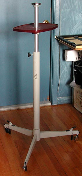

For a while I had a 1970s-era Linhof pedestal stand with a pneumatic rapid column that I really liked. The base has three legs radiating out from the center, and the pneumatic column is screwed into the base. You can put any head you like on it. It's perfect for most cameras up to 4x5" but wasn't quite strong enough for my 8x10" Sinar P, if I wanted to raise the column. It's on casters with a footbrake, so it moves around the studio easily without legs to kick like a conventional tripod. The column is removable, so it's also easy to ship. There is also a plastic accessory tray for it that slips over the column.
I've attached a photo that I found in my files, probably from when I sold it.

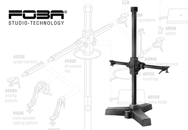

Stand?? Hmmm, never thought of that. How stable are they? I feel like there would be a bit of play once the main bar is quite high. Also, how is the grip on the castors? Are they usually made of rubber? The reviews on these higher end stands are really good.
I have a FOBA ASABA studio stand that I bought used for $450. It's fantastic! The configuration that I have costs about $10,000 new, but when found locally usually sells for less than $1,000.

fotch
Mar 16, 2005
4,774
SE WI- USA
I have 2 studio stands purchase used (around $125 each I think) that are way better in the studio than any tripods. I had to cut the column on the 10 footer to about 8 for my use. Really the cats meow.
