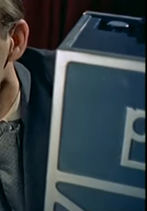

Pathé movie short featuring 1950s glamour girl, Sabrina. It features a square format commercial portrait camera of some kind. Any guesses on the manufacturer? Seems to be roll film taking at least 48 frames, although glass plates are mentioned.

The size and simplicity of design suggest it may be an adapted WW2 aerial reconnaissance camera. Pack films were popular for walk-in commercial studio cameras, but there are no obvious contenders. If it was made for studio photography it was clearly for use by non-specialists, although there is a reflex focusing device. The huge plinth was typical of portrait cameras of the era. Were there any falling plate cameras with designs this late? It looks more like a predecessor of the photo booth, or a direct positive camera.

The puzzling thing is that one expects a 42-lens camera, but it is not.
The clue likely is the logo of the manufacturer. But we only got the very first bit...
Could be "PL", which fits the chain that used that camera.

Well spotted. It's a Kodak department store camera. The Polyphoto explains the origin of some family photographs, which were too early for photo booths, but not large enough for a studio portrait sitting. The camera looks like it was designed to be used by non-experts. An interesting gap in photo evolution is now filled!

The way you word it, it reads like being one of those many Kodak cameras offered. If that camera being of Kodak origin is right at all, to me it rather seems the camera (actually 2 models) were custom-made for Polyphoto. More so seen the several photographic inventions of their founder, including multi-image.
It is a pity that the text at the front of the 48-Camera at the Science Museum site is not readable.

From the information you linked to, it states the manufacturer as Kodak. In all likelihood it was an amalgamation of the Polyphoto company and Kodak optical. Department stores go back to the c19th though they proliferated in the 1930s, when this camera came into being. The one in the film looks like a post-war example based on the same principle. The camera could be used by a semi-skilled operator who could undercut traditional portraitists. I have a vague memory of such a device being employed for shots with Father Christmas, and certainly recall seeing the photographs which matched the format of those in the film.
Department stores offered holidays to haircuts in addition to retail items. Whatever process was employed it is likely to have been quick, with plate holders and dark tanks based on the same system. The shots look like contact prints.

It's a Polyphoto camera, unfortunately, I"m old enough to remember having my portraits taken on one at a local department store ( some of which I still have ) when I was about twelve.
http://www.polyfoto.co.uk/
