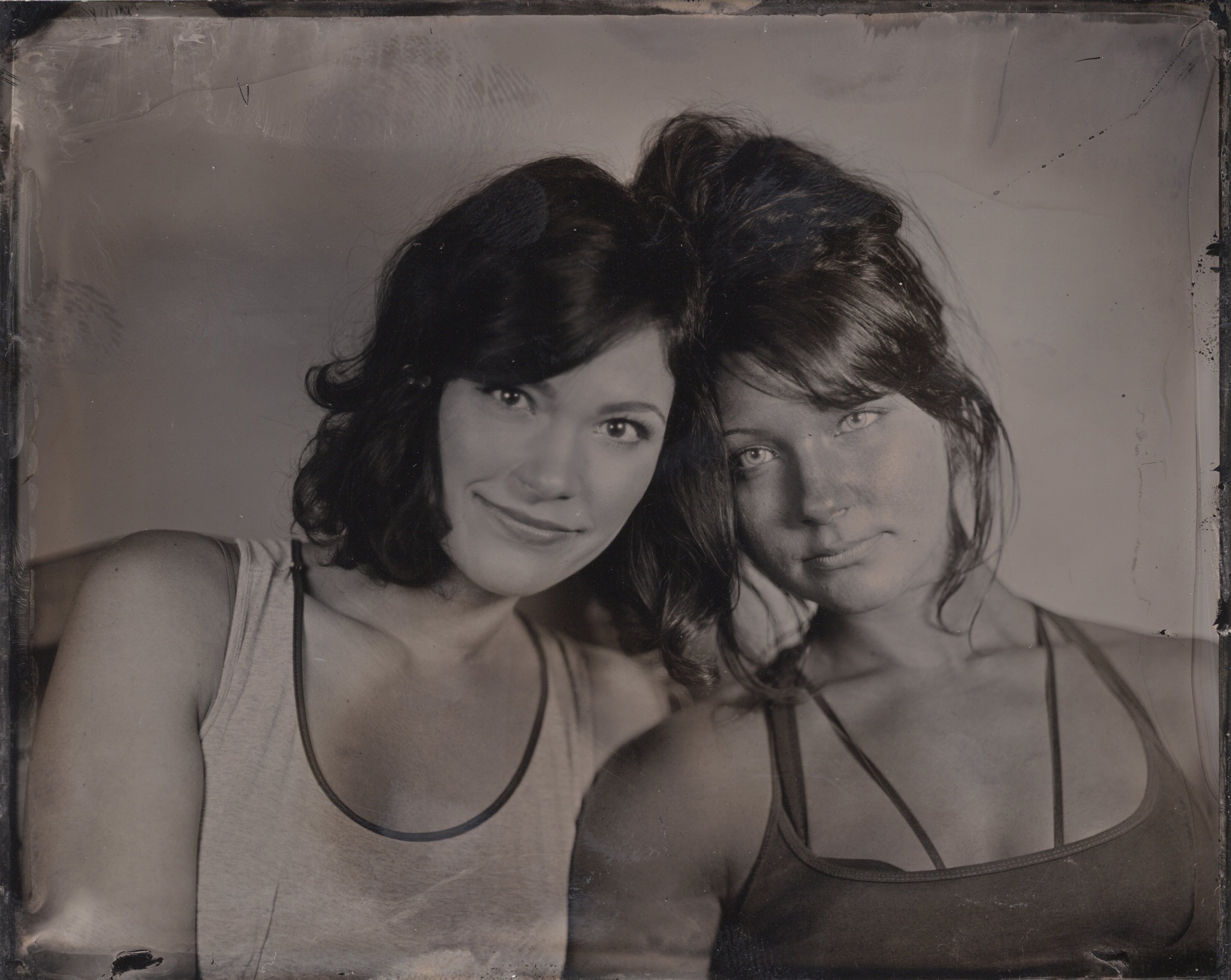

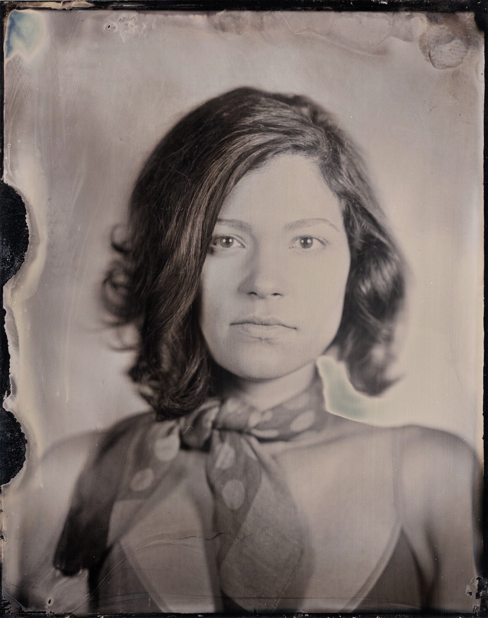

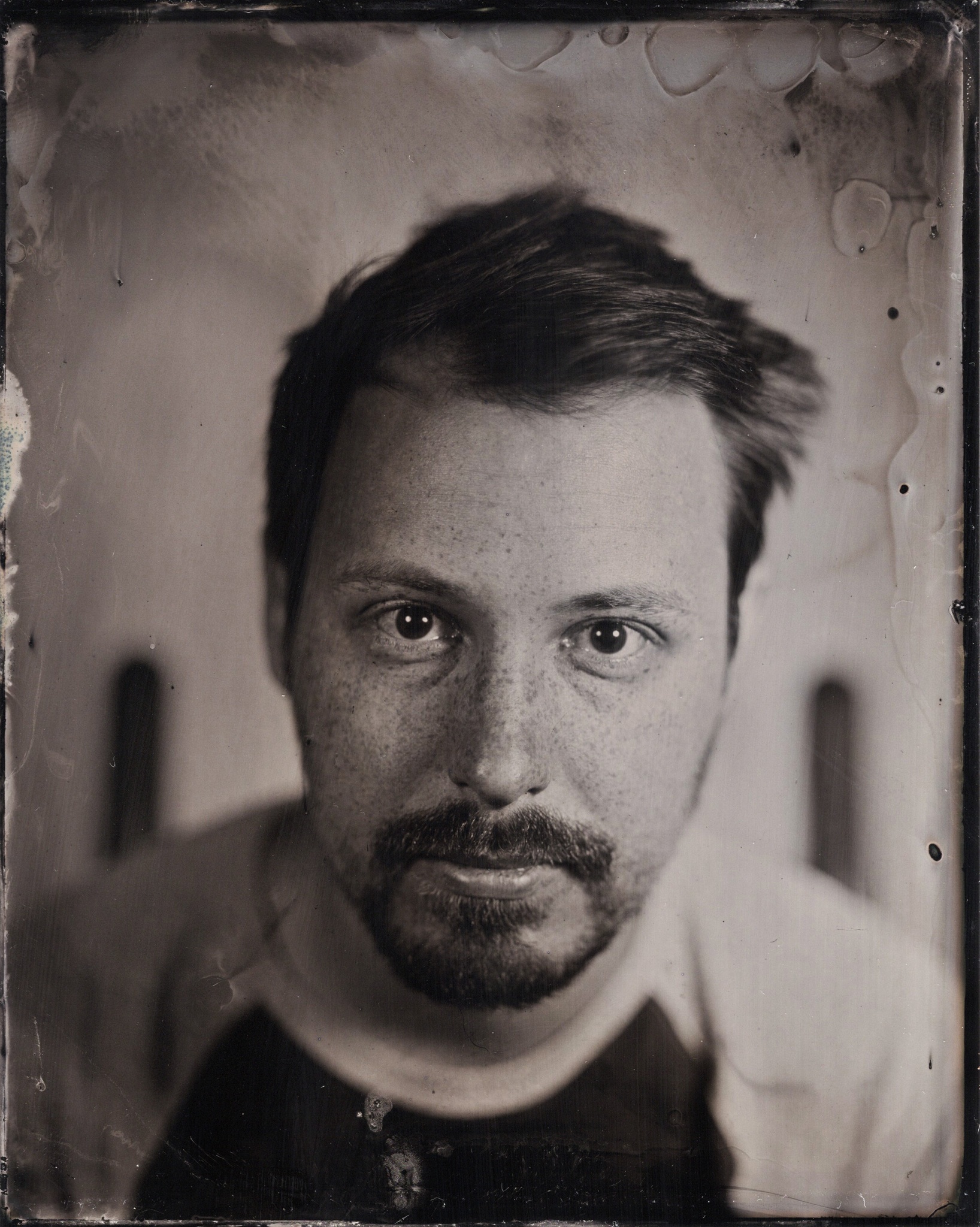

My daughter and I are just starting out with wet plate collodion and indoor strobe exposures. These are results from our first session.
The attached wet plate shots were done with one Speedotron 2400ws pack, split between two 102 flash heads with 11 inch reflectors aimed directly at the subject at 3 feet (ouch!!). The lens was a Schneider Xenar 210mm f/4.5 wide open. The amount of light was barely enough. I bought one more used 2400ws power pack and a third 102 flash head to double the power. That should allow some backdrop lighting and larger f/stops for less critical depth of field.
With the 210mm lens, bellows extension factor steals one stop of power on extreme closeups. Pulling back from the subject with the camera to head and shoulders definitely helps if available flash power is limited.

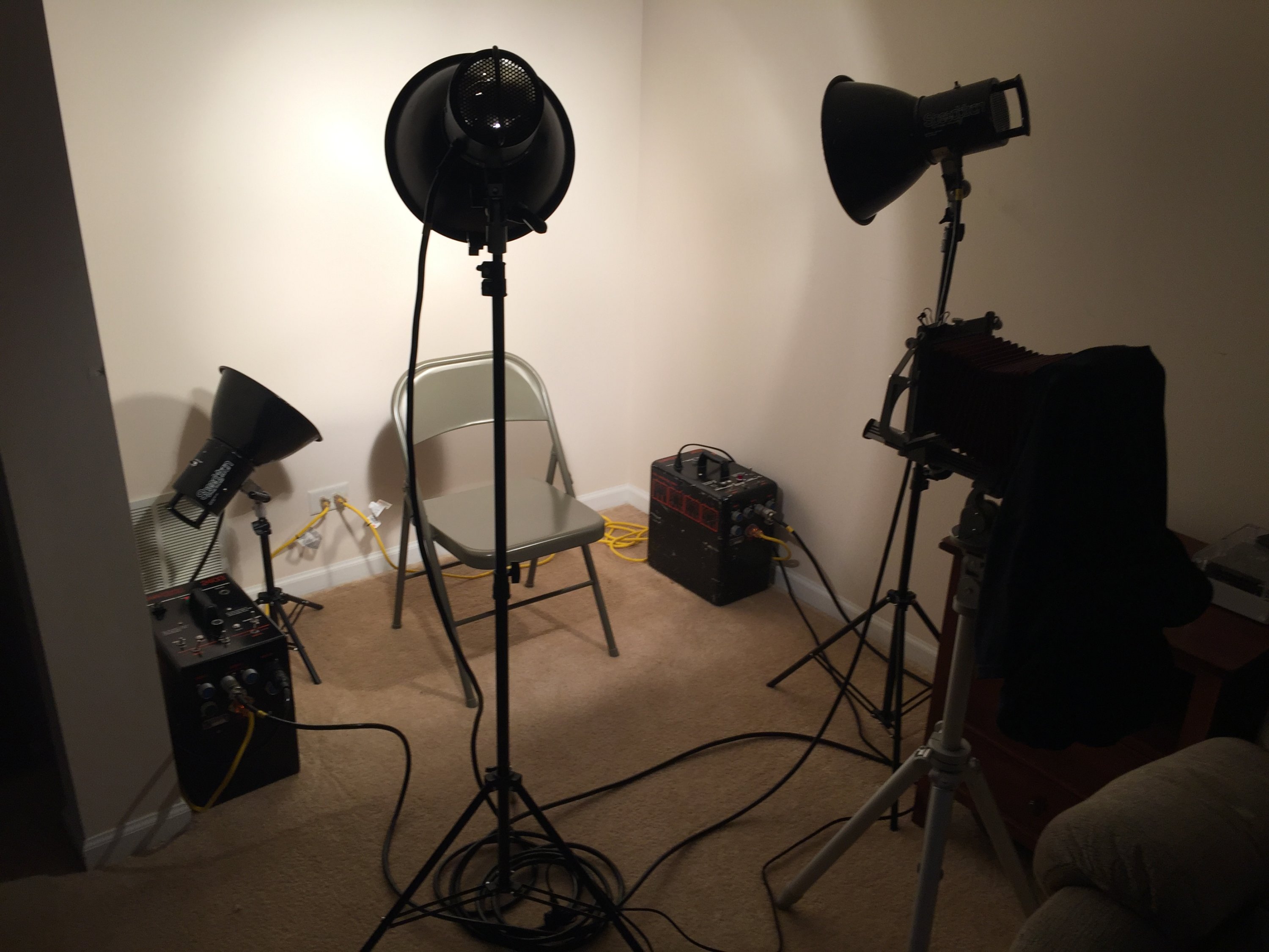

My second 2400ws pack arrived. I split it 2400ws to key light, 2000ws to fill light and 400ws to backdrop. I have one unit slaved to the other with a Wein L8 optical slave trigger. I fire the main flash with a wired push button, after loading the plate and opening the shutter manually. I could fire the system with the sync contacts in the Copal shutter, but separating flash from shutter operation gives a better pose from the subject.
I did try a few pops on myself. It is bright, with a few second after-image, but certainly not permanently blinding. The heat wave is impressive.
Don
