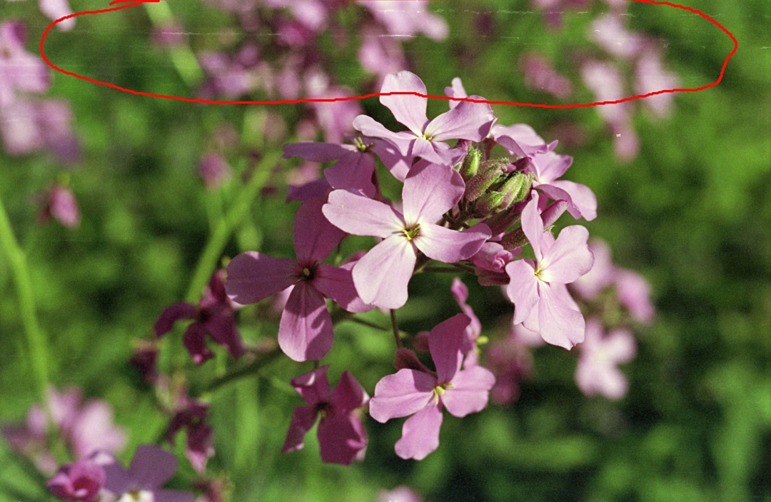

I recently acquired 400f of Fuji Eterna 250D, it has a RemJet layer and I did what everyone else is doing, prewash it with 1 liter of warm water (40c) plus 1 tablespoon of Sodium Bicarbonate, agitate like making a martini for 1 min and then rinse with warm water it until nothing black comes out
The first time I developed it it worked with no issues at all, I loaded a 12 shot roll and did some test shots, worked perfectly, after that I loaded a 36 shot roll and tried again, this time I was able to remove like 50% of the remjet and It was next to impossible to remove the rest!, I tried to clean it with a wet sponge but unless I do it very aggressively it wont come of, I also tried using 2 tablespoons of Bicarbonate at 40c, same thing, leaving it longer on the remjet remover solution, same, increasing the temperature of the water to almost boiling and adding 3 tablespoons of bicarbonate, same thing. Also always sticks on the middle of the film, the sprockets come very clean.
Is there any way that maybe wile loading more frames I'm somehow compressing the roll to much inside the cassette and making the remjet stick more ??
I using Arm & Hammer baking Soda and doing it before processing in C41 from the colortec press kit on a Jobo CPE-3, the film was stored in a fresh place but no refrigerated, it is since now been refrigerated.
I also checked somewhere else that there is another more effective formula to remove it Borax + Sodium Sulfate + Sodium Hydroxide and that is supposed to be amazing.
I you guys have any suggestions of what I might be doing wrong, I'm all ears!!!!
I really want to use this film.

I just processed a roll of Kodak 500T and can confirm that the official remjet pre-bath is more effective than a simple solution of bicarbonate. I didn't have any sodium sulfate either, but created the molar equivalent in situ using sodium bisulfate and potassium hydroxide. Bicarbonate might remove 2/3rds of the remjet at best, but this run was closer to 95%. I filled the tank with the pre-bath @ 80F, gave a gentle twirl of the reel, drained the still-clean prebath, refilled with water, inverted vigorously, and drained the jet black effluent. Essentially all the remjet seemed to be removed in the first wash. The base side still requires a wipe down but there's much less risk of the remnants becoming embedded in the emulsion.
My experience with remjet'd films is that the backing becomes more difficult to remove as the film ages. You might look into what techniques people have used to deal with the remjet on a much older/expired film like Kodachrome.
Edit: Some frames in the initial scans show the remaining contamination fairly well. Since the remjet is on the base side these could conceivably be rewashed now that they've been cut into more manageable strips of 6.
