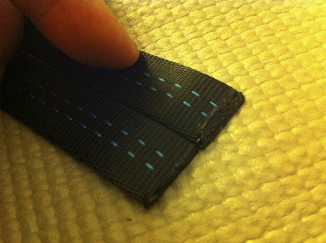

Mark and set webbing on a durable flame/heat resistant surface. I held the webbing taught with two soup cans. (This step can be omitted if you are ordering only one length of webbing for one strap, I bought multiple lengths)
Heat razor blade under medium-low flame for 45 seconds to 1 minute. (be sure to wear your goggles) and cut through webbing with firm downward pressure.
You can either leave it as is, or you can smush the edge of the webbing flat with still hot razor. Diagonal cuts maybe easier to insert in next step as well.

End result. I also tapped the ends with gaffer tape to make them extra secure. They work very well, the rings don't grind on the side of the camera as the webbing is wide enough to protect it. Ladder locks work well to secure the load, and are a bit easier to insert and configure. Triglides are more traditional and slightly smaller. Instead of using an open burner, you can also use a lighter or matches, but there will be some fumes, or you can opt to just cut and super glue the ends to keep from unraveling.
