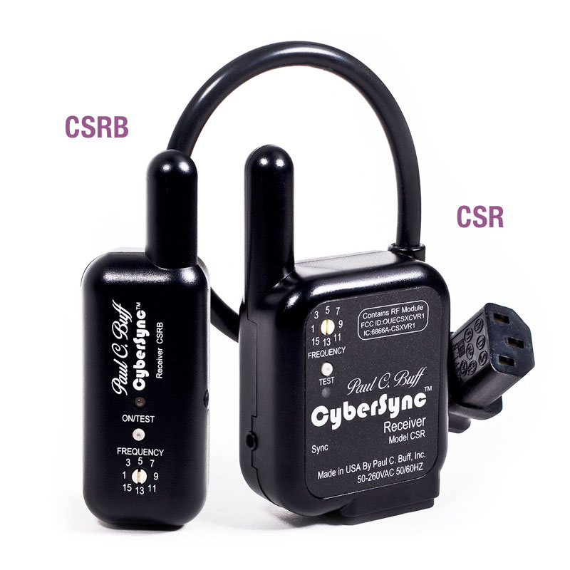

Anyone have any experience with these from Paul C Buff?
This is the receiver. They have a version where you in-line the power cord to the strobe, so it doesn't need batteries. They want $70 for this.
This is the transmitter. They want $60 for this:
Seems reasonable.

Omaha, I have those Paul C. Buff Cybersync triggers. They're quite reliable and I'd recommend them. They do use button cells, though, instead of AA or AAAs.
omaha
omaha
Jun 16, 2013
368
Oooohhhh. That's an issue.
If I go this way, I'll get the AC powered one for the receiver, but the transmitter is going to be battery. Did you have issues with battery life?
