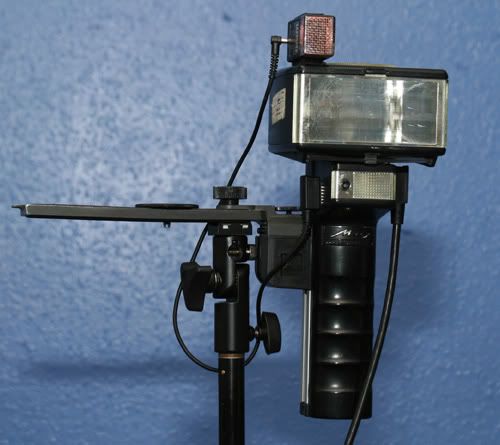

It sounds like you are in a similar situation to me.
I hankered after a set of studio flashes for ages, and eventually borrowed some.
They are nice for some things, but by no means essential, nor universally useful.
After that, I bought a pair of hotshoe brolly adapters, which allow a brolly and stand to be used with a hotshoe flash.
I'm using a Canon 430EX and a Metz 60CT4 at the moment, which work well, but the metz is a bit big, and needs to be bolted on to the adapter, as it's not a hotshoe flash.
This system works really well for me at the moment. It's versatile, light and will go anywhere.

Unfortunately that doesn't work, as there's no way to attach a brolly directly to the Metz. - and even if there was, the flash head would be way off centre to the brolly
The way I set it up is to flip the metz camera bracket upside down, and pass a 1/4" thumbscrew through the 3/8" hole into a 1/4" tapped hole in the hotshoe/brolly bracket.
That gets the flash head somewhere near the middle of the brolly.
It works pretty well, but the main problem is the physical size of the whole metz caboodle - you have to find somewhere to put the big generator pack.

Metz generator pack= extra stability.
I have an extra cloth loop on one end of mine, that I made up from some old pack webbing andn replaced the offical steel ring when it broke off. I use this loop over the screw that holds the light stand leg clamp. That way when you move the light stand everything moves as a unit. It also adds more weight at the bottom of the light stand. When I put the umbrella and CT head on top, a bit more weight on the bottom never hurts.
Good idea. I might try that.
I have on occasion gaffer taped the generator to the bottom of the wheeled stands we use at work (normally for video lights)
A while back, I did a shoot on a rather wet beach, and keeping the generator out of the sand and water was really fun...
