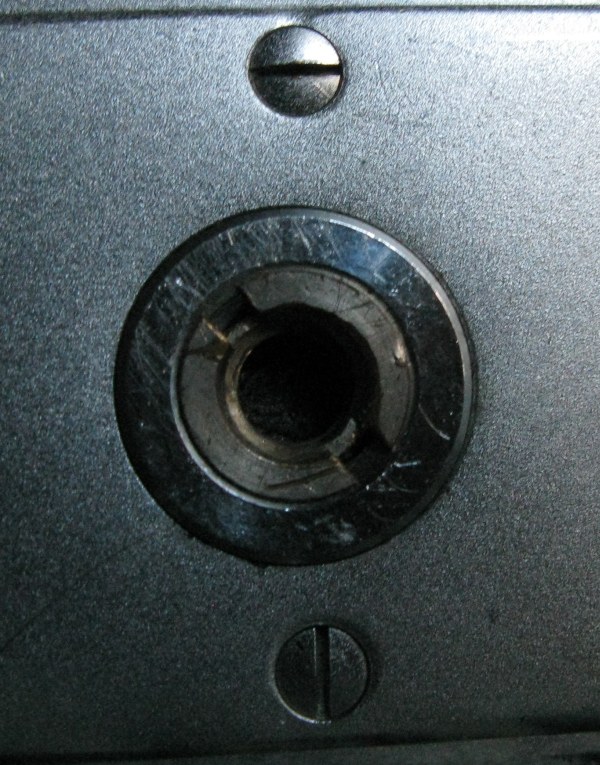

If it looks like the image which I have hopefully attached and has a couple of slots for a screwdriver to fit, then it is very likely an insert and you just need to get another one. I assume that you are in the US, in which case someone near you probably has one they could send you. I am in the UK. If you are closer to me, I could send you one.

Ah, I see... Unfortunately, mine appears nothing like that :pouty:
I've taken a proper look now, and it appears as though someone didn't like the original 3/8 hole, and instead of using a proper insert, used a (looks like brass) helicoil to reduce the size to 1/4.... If you shine a light in, you can see the that threads end halfway up the original tripod socket.

You should be able to drill out the insert quite easily if it is brass. Start with a drill just slightly larger than the hole and increase in diameter - but don't go bigger than 1/4!"
Another method would be to superglue a 1/4" bolt into the thread then unscrew it from the 3/8" thread.
