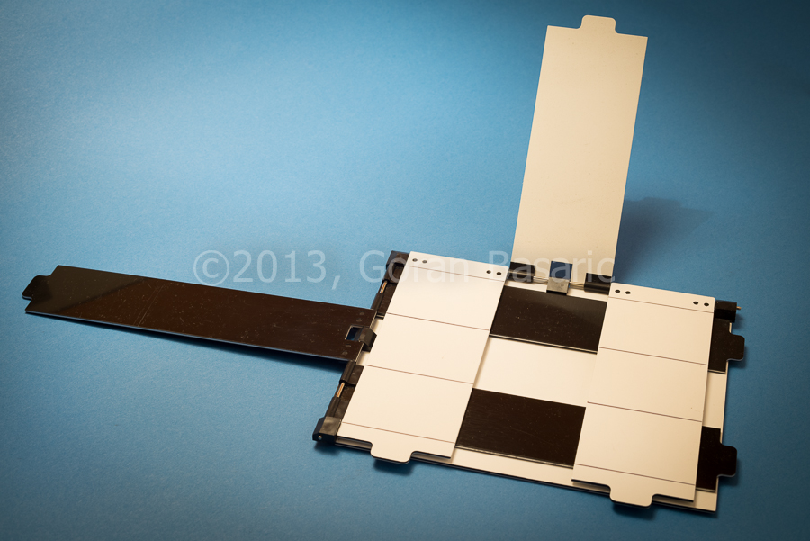

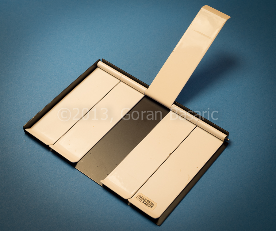

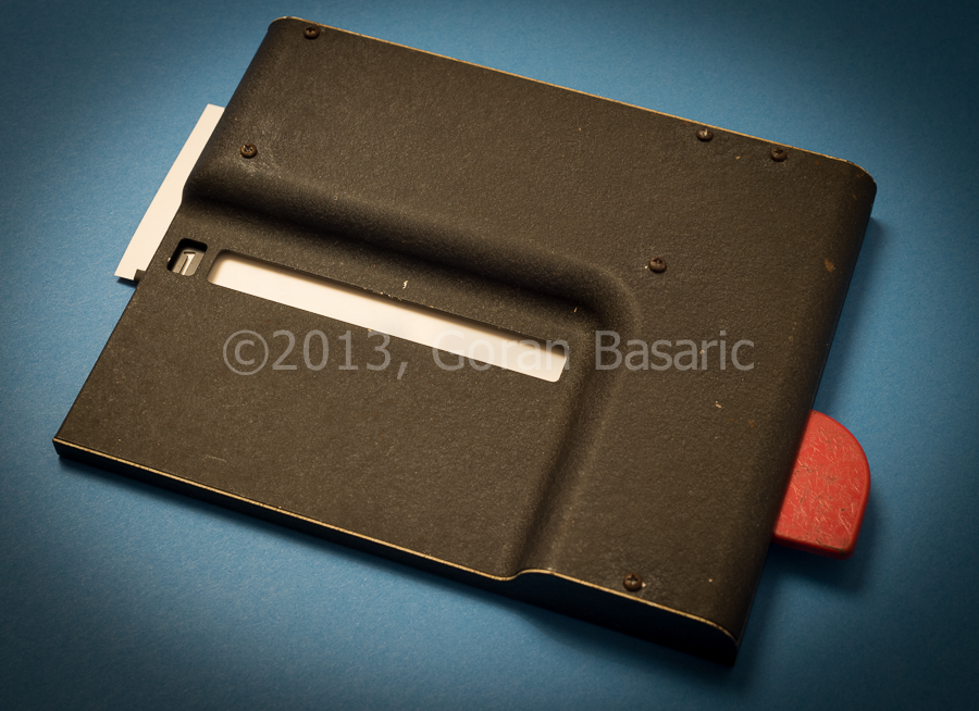

I like to have test strip easel handy when I'm printing in darkroom, I'm not using them for every test print. For years I used simple Czehoslowakian Meopta tester.

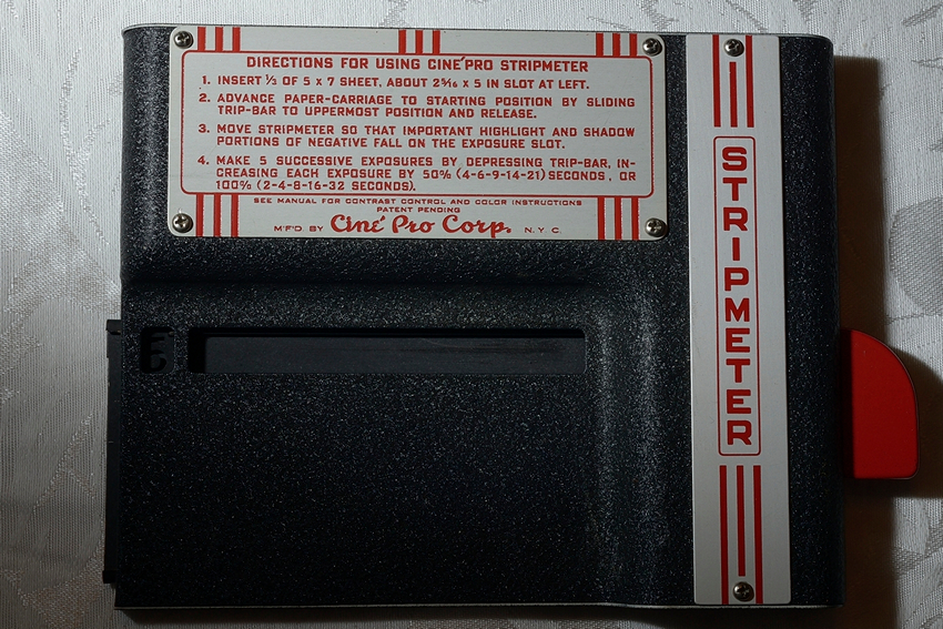

Yesterday in Seattle I found this amazing strip test easel. Unfortunately there is no any stickers with name of manufacturer on it.
It's beautifully made with out one single piece of plastic. All solid metal. With baked black paint.
Simply load piece of photo paper size 60x130mm or 2 3/8x5", cock mechanism and then every press on red tab and it will move paper and open new strip of paper for the test exposure. Test slots are 11mm wide. It even has stencil numbers for strips from 1 to 5.
Most likely made in '50 or'60. For sure, they do not make stuff like this any more. Did anybody see strip tester like this or similar? Any idea who made it? Must be American?! In the past, they build great, quality stuff like this, to last forever.

I have a friend who has one of these - we were looking at it on Saturday.
Originally it had a brushed aluminum surface attached on the front with engraved labeling - including the instructions.
I'll see if I can get a shot of it from him.

Goran:
My friend is going to scan the face of the test strip easel for you and I'll forward it on.

My friend, Dennis has sent me digital shots showing the labeling on this when it is complete.
One is the entire front service, while the other shows an enlarged image of the label.
Hope this helps.

Dec 10, 2009
6,297
I found one on eBay for $5 made by Patterson. It takes 4x5 paper. Changed the way I print.

Thank you Matt! Quite interesting labels. Never heard of that company.
I was wondering about from where did 60mm wide strips of paper come from?
It did not fit 8x10/4x5" proportions and I confirmed it while cutting paper.
All the best!
Goran
You are welcome, Goran.
I expect that the 60mm width is about 1/3 of a 5x7 sheet of paper. EDIT: And in fact, the instructions refer to 5x7 paper!
