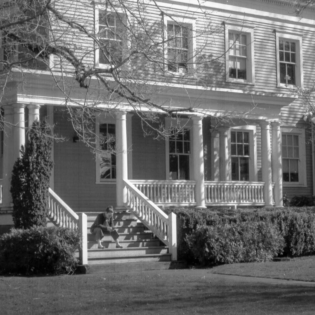

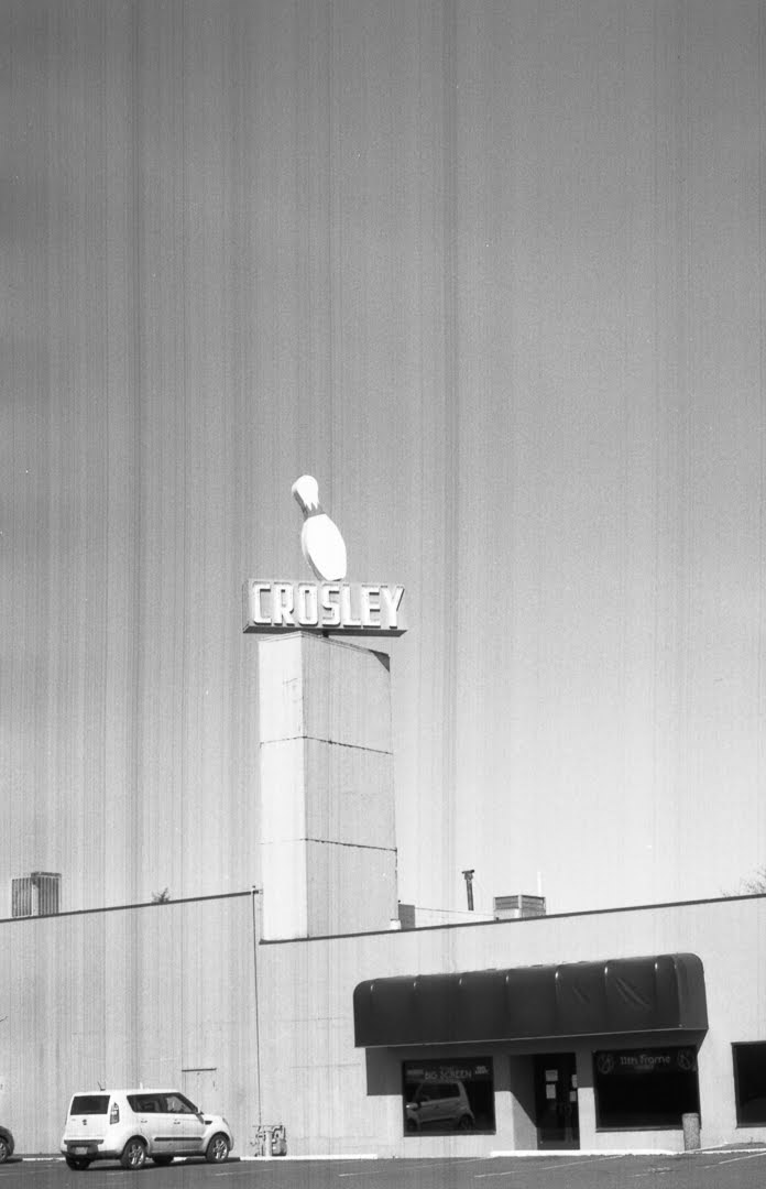

Looking for ideas on what is causing these striations the entire length of this roll of film. I've attached a picture. This roll of Arista EDU Ultra 200 was bulk loaded onto a previously used cassette purchased on eBay as part of a lot of lab processed rolls for bulk loading. This is the first bulk loading I have done and I used a brand new Lloyds loader. I cleaned out the loader before first use including running some exposed film through the felt light trap. The camera I used was a Pentax Spotmatic F that I purchased on Ebay one year ago and this was its first use. I checked my other four bulk loaded cassettes to see if the leaders showed any sign of scratching but they all looked clean. I also checked the interior of the camera including the pressure plate and that all looked clean.
Development process was Cinestill df96 monobath with FotoFlo finish and hung to dry with no wiping of the negative strip. Scanner is an Epson V600 using the negative holder. I've developed many rolls using this process with no issues so I'm thinking this is narrowed down to one of the first time new things I did with this roll.
I'm going to run another roll of film through a different camera tomorrow and see how they develop with the idea of doing a process of elimination. Possible causes I'm reading about are dust/grit particles in the felt of the loader or the cassette, or the same in the camera. I picked the attached example because it has a lot of visible sky which is where the striations are most obvious. I'm also attaching a photo with no sky in which the striations are less obvious. Thanks for taking the time to comment on this.

As straight as the lines are, it almost certainly has to do with the film path in one of three things; your loader, your camera aperture or your film cassette.
Personally, I would suspect in order the felt in the loader, the cassette and finally the camera gate.

Dust, no, but something like sand etc., possibly. But it's very difficult to get film scratched this way. The only way I've come close was by using a bulk loader wrong: by spooling the film without opening the gate. The film then drags with the emulsion side across the plastic of the light trap, which can cause these kinds of striations.
So given what you've told about this roll, I'd look at how you used the bulk loader and if perhaps you made a mistake here. What kind of loader is it? E.g. with this type:
it's essential that you close the light trap, tape the leader of the film onto the spindle, insert spindle into cassette, close the cassette and put it into the loader. Then close the lid, open the light trap by rotating the outer rim on the large part of the loader and then spool the film. When done, close the light trap and open the lid, cut off the leader and repeat for the next roll.
My guess is you forgot that bit about the light trap.

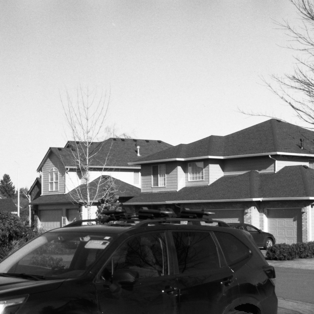

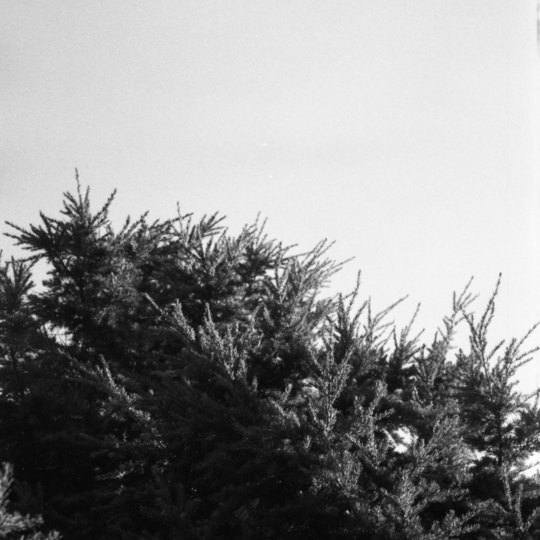

Result of today's test. No striations using the second bulk loaded cassette in the shots from the Spotmatic and from the known good camera. My assumption now is that it was the previous cassette. The test pic with the house and car is from the Spotmatic which I used with the problem roll and the juniper tree top is with the known good camera, a Sears KSX.

Yeah, that's possible. If you still have it, I'd inspect it to verify; it helps to know what the problem is/was.
I did and the only thing I noticed is there was barely any upper felt. I'm wondering if during loading on to the spool if the film was contacting the metal lip of the cassette. The bulk film was taped to the stub of the old spool film with scotch tape so perhaps the tape pulled back on the what little felt there was exposing the metal lip.
