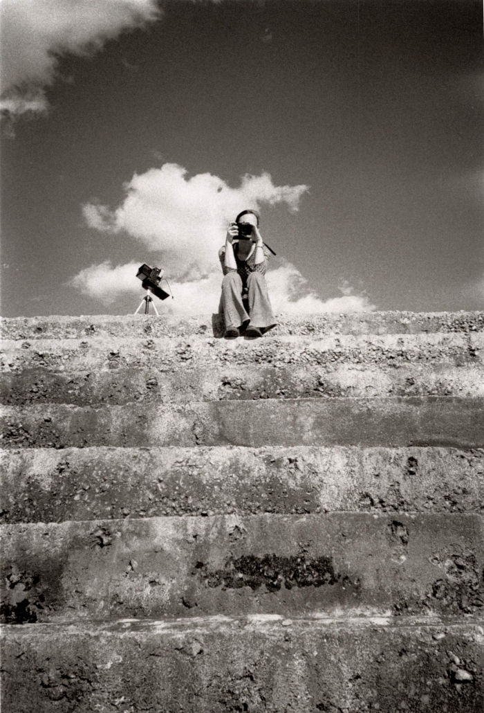

I've found that I occassionally get streaks in the sky when I use diafine on bright days. I use diafine at night 95% of the time, and it pretty much only gets used in the day if I have a roll of film to finish off.
Sometimes I get streaks in the sky which look like light leaks. The camera is a Leica M3 in excellent condition, though it is 50 years old. Rating film at normal speed and using normal developer, these streaks have never appeared.
Is it perhaps minor holes in the curtain usually not noticeable, but exaggerated using diafine, or a chemical issue?

To me it looks like bromide drag from the sprocket holes but it's difficult to tell from that web image.
The one thing that has held me back from experimenting with diafine is this type of uneven development that I have seen mentioned on the net.
Like I said, I've never used it but it seems that agitation is a tricky thing with this stuff. I've read about it time and time again. Some experience no issues and some have problems. May be tied water quality???
Did you mix it using tap water?

I mixed the diafine solution with de-mineralised water, as with all my chemistry, water used for washing is tap water. I'm unsure of the water quality here, have never really had any issues apart from the streaks above with diafine.
I've been using diafine for all my pushed film for the last two years or so, have probably processed 150-200 rolls in it. I've never had any problems in the low light films, just daylight. I don't particularly like the look of diafine in daylight, so I tend to avoid it.

My take on it is agitation is touchy because on the one hand you want the solutions to soak into the emulsion to give the speed boost in the shadows but if you don't agitate enough you get this uneveness/bromide drag issue in heavy exposure areas.

I was not aware of the issue....I guess I just started using it one day without doing any reading!
I give it very gentle agitation for 5 sec per minute, and tend to avoid over agitation. Perhaps I should give it heavier agitation and see what happens.

Same thing happened to me with the first roll I did in Diafine. That was agitating gently 5 seconds every 60. I changed to 5 secs every 30, not so gentle & never had the drag again.

I've got another take on this:
These streaks are unevenly spaced and also not vertical. In fact the angle changes as you move across the frame. In my mind that discounts the sprocket hole streaking from uneven development theory.
Also one the streaks on the right seems to be going right down the frame from top to bottom – that is not also something that you are likely to see in sprocket hole streaking from my experience.
The streaks are light in colour and that means that the neg is darker there, not lighter. In socket streaks you get lighter bands under the sprockets. The bands on the print are darker due to thinner neg.
That strange angle makes it look like something else. Like light from a source at the right-hand side??

Looks like bromide drag. Randomize your agitation movements. Don't use the same motion for each agitation cycle. Invert the tank in a variety of different motions. Agitate vigorously and randomly for the first 30 seconds.
To test the effectiveness of your technique: uniformly over-expose a few frames at various frames locations on a roll. That is while shooting, shoot the sky and over expose it a three stops (shooting way out of focus will help the exposure uniformity). Repeat on say frames 1, 12, 24,36. This doesn't use much film and will provide a lot of information. Agitation changes depending on the position on the reel. If the negs are line free you are agitating well.
If all else fails use a more forgiving developer i.e. T-max or D76. .

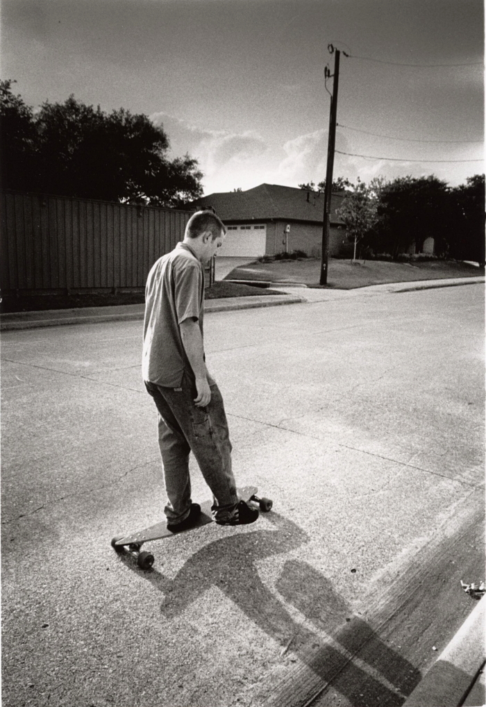

I've used tons of Diafine. I have had this issue before. I agitate as little as possible with Diafine because I think it keeps the grain down. When I went to super-minimal agitation or stand developing, I got the streaks. First of all, I only worry about agitation for the second bath. For the first bath I agitate 10s then let stand 3 minutes. For the second bath I like to pour it into my stainless 1-reel tank, and then now I agitate VERY GENTLY, more or less just rotating the tank slowly and randomly, for the first 5 seconds of development, then for 5 seconds every 30 seconds. I think that this took care of my streak problem, but I haven't shot as much diafine as I used to.
In this pictures you can see the streaking in the sky
Firstly and off-topic, I love the quality of your photographs.
Back on topic, your streaks appear to line up with sprocket holes and run perpendicular to the film edge but the OPs do not. So yours looked like uneven development. But as I have described in my earlier post, I think the cause in the OPs case may be different.
