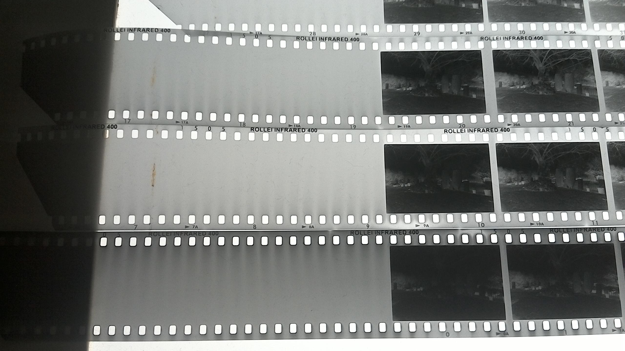

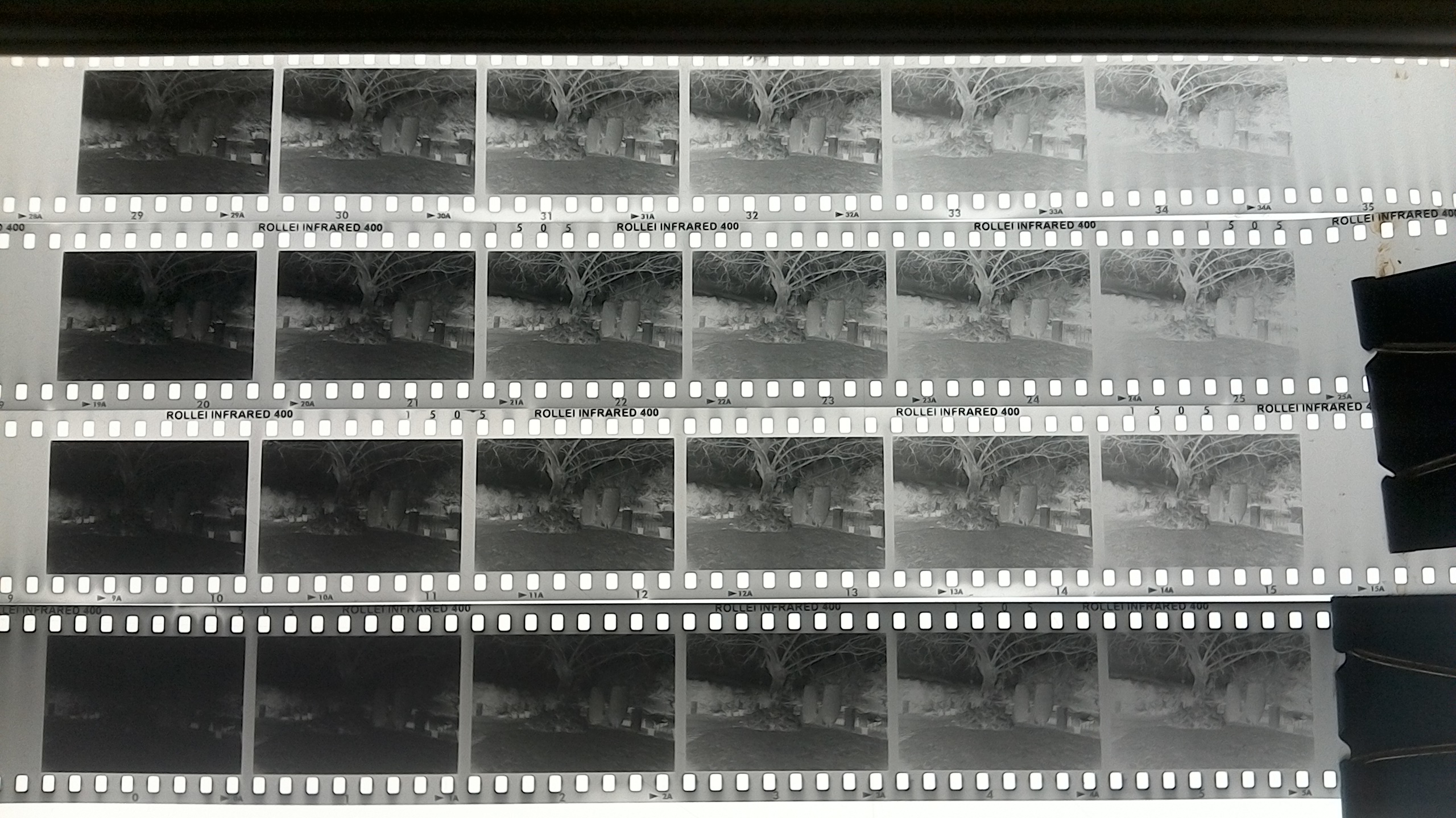

I've been experimenting Anneman-Gainer Developer. I found the formula here:
https://www.flickr.com/photos/carljmoss/6244540929
It's meant for stand development, and it's supposed to give a two stop push. My goal is to be able to shoot Rollei Infrared with 720nm filter at ISO 50. From the results I've gotten it looks like this is going to work out, except I'm getting a lot of streaking. A lot of it looks to be coming from the sprocket holes. I only shoot infrared in 120, so I'm not sure if this will be as much of a problem.
Does anyone know of anything I can do reduce this?

Looking at the film strips, I'd say that you are dealing with a problem of optical/light fogging and not necessarily a development issue. Notice how the bottom strip suffers from severe fog throughout the film width, while it is already significantly less at the 3rd strip and almost gone at the top strip. This implies that there was a light leak somewhere, possibly related to the development tank (faulty light trap) where the first frames are at the center of the tank, close to the core, and the last images on the roll are on the outside.

I see three artifacts here:
  1. slightly uneven lighting
  2. poorly reproducible fogging of the film
  3. visible streaks around the sprocket holes
The fog may come from differences in TEA quality. If your TEA gives higher pH, you will get fog. Maybe add something to lower pH until your film remains fog free.
The streaks come from inadequate agitation. There are multiple "churches of stand development", and the most sensible preach "agitate at least every five minutes to avoid streaks and bromide drag".

The bromide drags are from low agitation. If you were using sheets instead rolls a solution would be developing in trays, in that way the film horizontal position does not help gravity to make the drags.
You may try semi stand, or agitating very, very gently several times during development, not enough to refresh much the chem inside emulsion but diluting a bit the bromide concentration on film surface.
Let mention that the drags are not the dark ones falling under perforations, but the the lighter ones falling between perforations. The drag comes from denser bromide falling, and as Br is a restrainer less silver is developed.
Most of speed increase comes more from the stand development than from the developer itself, so you may use other stand recipes not producing drags.

Thank for the suggestions. Maybe switching to minimal agitation is the thing to do. I'll likely try that next. Just for reference, here's how each film strip was processed:
1. 1:100, 60 minutes
2. 1:100, 90 minutes
3. 1:50, 60 minutes
4. 1:50, 90 minutes
I did 30 seconds initial inversions, and 5 inversions every 30 minutes. These are from ISO 6 to 200 in 1 stop increments.

OK, I did not realize you developed these strips separately. That obviously makes my earlier comment irrelevant.
I agree that a semi-stand/minimal agitation approach is probably a better idea. And also keep the development time limited to an hour if the 1:50 dilution is used.
Your test was actually pretty neat in determining the boundaries within which fog remains acceptable!

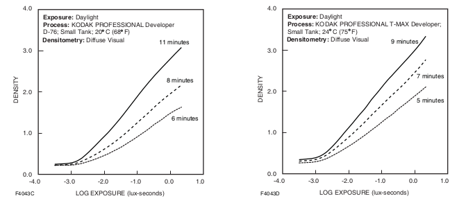

What I mean is that we may make a 2 stops push with any developer, but XR-1won't be much different about true speed.

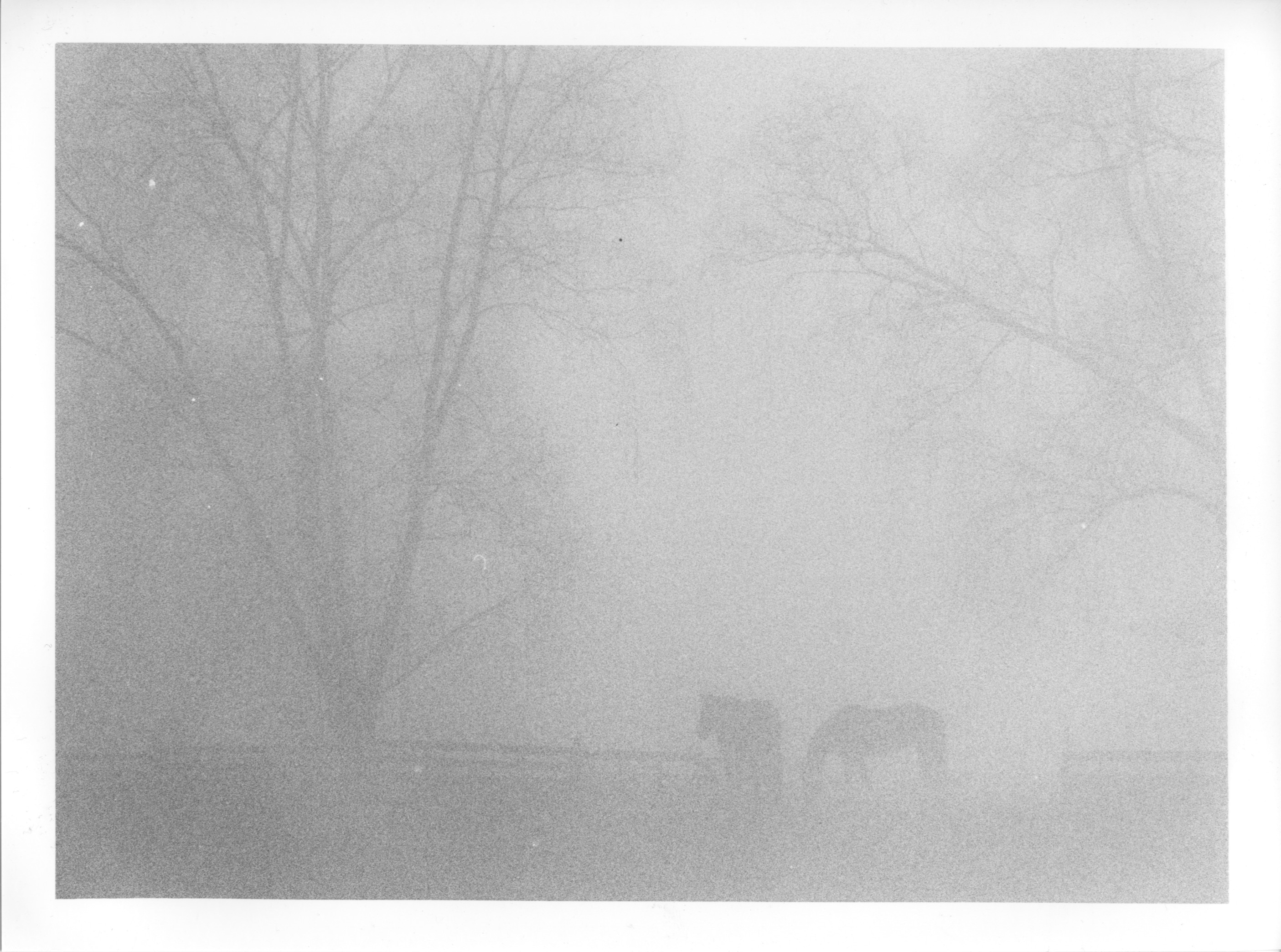

If you look at the H&D curve, even that of very modern film will have a pronounced toe. If your subject matter is within this toe region, forced development can determine, whether this toe contrast is just high enough to make a grade 5 enlargement look ok. I accidentally once underexposed Delta 3200, I tried to expose at EI1600, but then set the lens to F/32 instead of F/11. I gave that roll a hefty dose of overdevelopment, and could get wetprinted images out of that roll. Grain was the size of golf balls, and there is no shadow detail to speak of, but the negs were printable. Weaker development would have required grade 7 or 8, something my enlarger can't do.

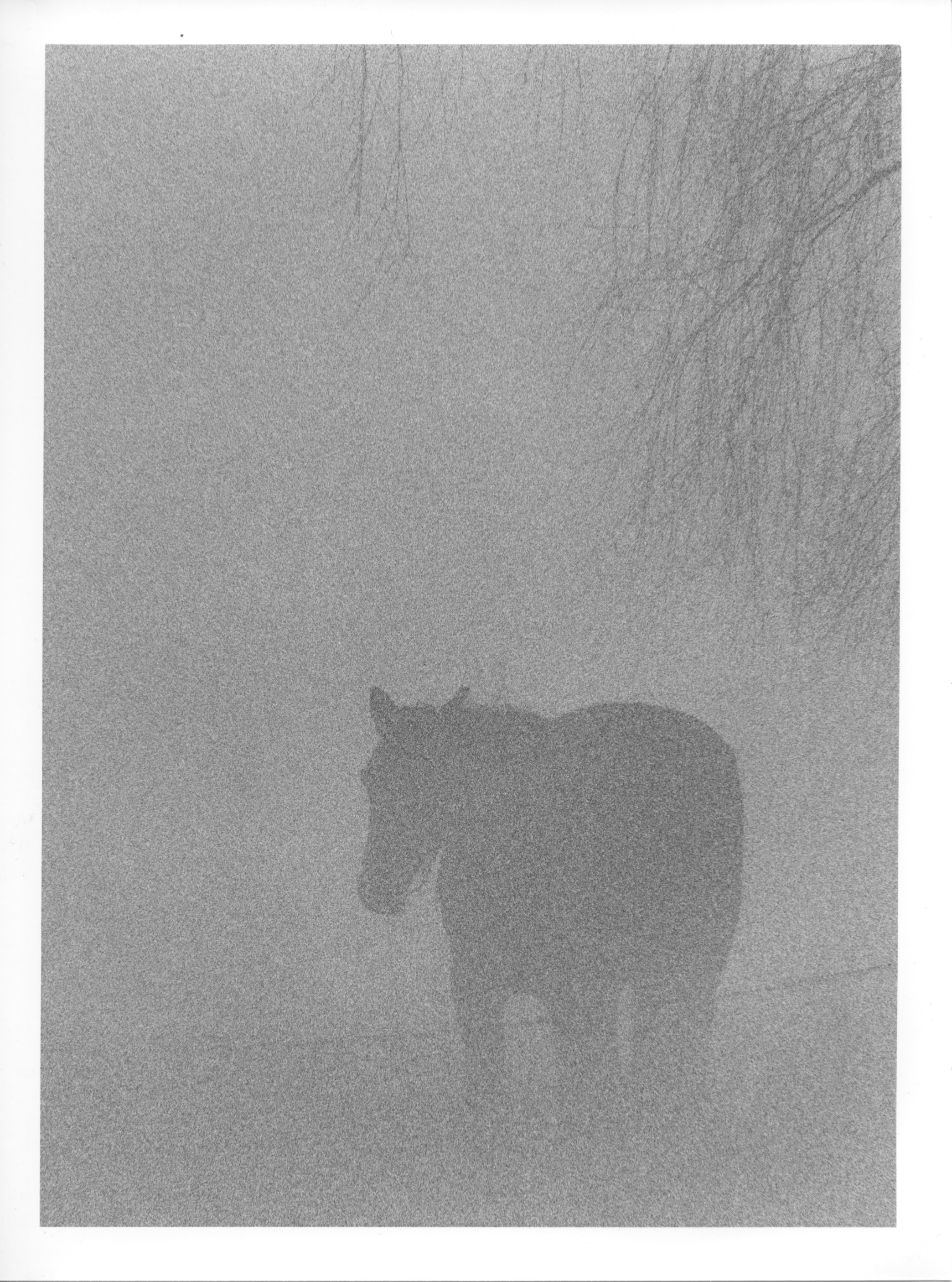

The attached images are examples of scanned 18x24cm prints made from 6x7 negatives. Obviously there was no two stop speed gain or anything, but I did get images.

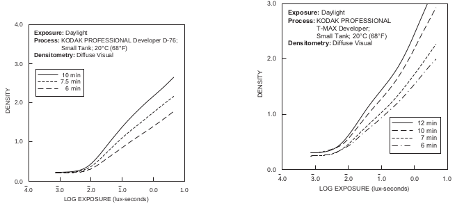

Anyway not all modern films have a pronounced toe, for example TMX / Y are very linear, for example.
Delta 3200 would be an archetypical case of a film with a narrow toe, yet its toe is there and covers quite some range of exposure. Look at these three H&D curves, these are the most advanced B&W film which come to my mind, and for each film there are at least 1 or 2 stops of toe region with contrast ranging from completely useless all the way to printable:
Delta3200:
TMAX 3200:
TMAX 400
138S
Dec 4, 2019
1,776
Pyrenees
As each H unit is 3 1/3 stops the range in the TMX/Y thats's not linear but usable is under 1/2 stop. Additionally you usually have a lot of flare % in that region, so usable toe of TMX and Delta is quite irrelevant.
Instead TX and TXP , for example, have a non linear behaviour until well higher densities, TXP (depending on processing) may be non linear until 0.5D, a particular case is TXP (EI 80) in HC-110 (1:31, around 5 min IIRC), which allows a creative shadow detail compression that's amazing for some kind of portraits. Several portraiture gurus have been using that resource alongside with other features in that curve.

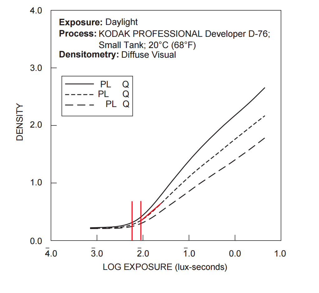

There is no such flare problem if the whole scene mostly lies within the toe region. Nobody in his right mind would suggest pushing for well lit scenes, except for maybe very special artistic purposes.
Regarding toe region: I cropped the toe region of TMY-II and marked the toe region of the pushed curve, and I do see at least a whole stop of variable contrast toe region, some of which actually reaches into the ΔD>0.1 area. The toes of graphs showing lesser development are even longer:
Well, this is elastic :smile: my view is a bit more restrictive (clik to enlarge):
At left of that you have nothing worth.
