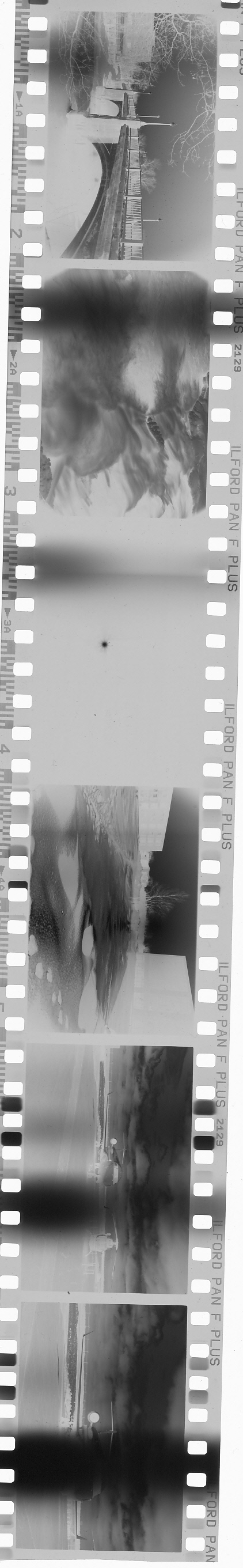

Ok this is what i mean by streaks...click on the image below

Looks like a film canister light leak to me.
Yes, and that explains why only the center part of the tank has these streaks as well, since it's the part you load onto the reel first, i.e. the part closest to the canister light trap.
Advice: load and unload in subdued light, and store exposed rolls in the dark, such as the Ilford black canisters.

Something has a light leak. It could be the center trap of the tank is leakkng, or the film cannister(s) leak, but whatever it is is a light leak.
You see, your problem description was vague enough that until you posted the negative scans, we could not make an accurate judgment.
Now, we are closer to the problem.
PE

That has nothing to do with the processing or tank, it's happening earlier. A crack in the tank would leak developer and the foggings too close, maybe a camera back light leak. That's more likely.

I'm with Ian; that looks like an in-camera light leak to me; check the light-tight seals on the backs of your cameras - you say you've changed them recently so that could well be the problem. It's odd that it moves positions between frames - perhaps there's a leak that only occurs under certain circumstances, like sunlight hitting the camera at a certain angle.
If it happens with both cameras, either you're very unlucky or the problem's elsewhere. You say it didn't happen at all on a roll of Velvia which makes me wonder whether you're bulk-loading your Pan F Plus. But the edge numbers suggest otherwise. It might be worthwhile exposing a roll of C-41 under sunny conditions, having it developed and seeing what happens.
By the way, the use of dish soap in the final rinse has been deprecated in favour of wetting agent. :smile:

Kevs probably hit the nail on the head a poor cassette light seal. I've almost given up on 35mm after ratherv a long time :D and I only saw issues like this very early in my processing, I always paid a lot of attention to the cassettes I reloaded after that.

Most likely the film cannister(s). However, the tanks light trap could be leaking allowing a band of light to fog the film.

Every either 35 mm canister i have used from fuji, ilford and kodak was defective or the job i did rebuilding the seals on my camera back is bad...sounds like i have an answer. Thanks so much guys!! very appreciated. I'll redo the seals and come back to report once i have some new results.
