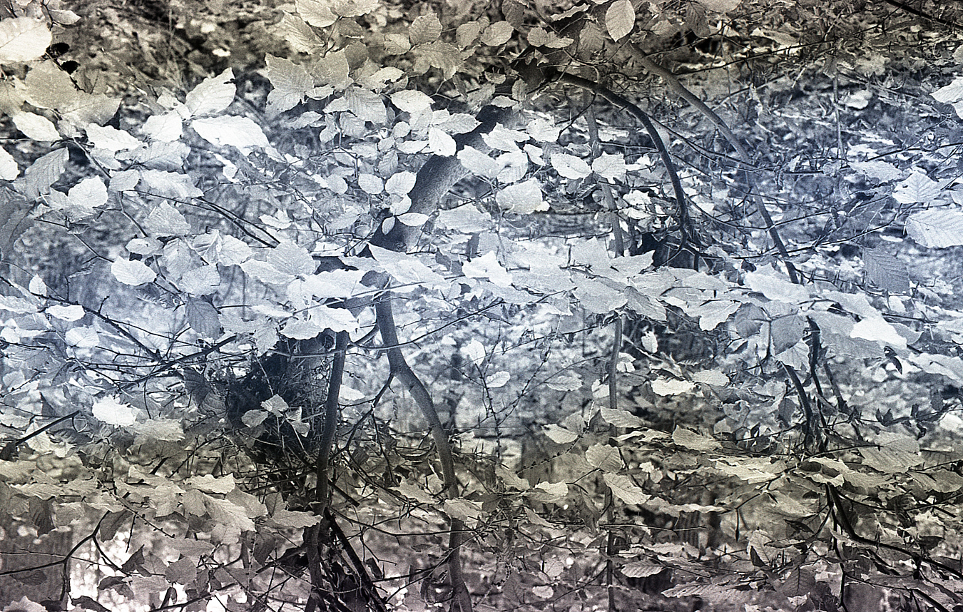

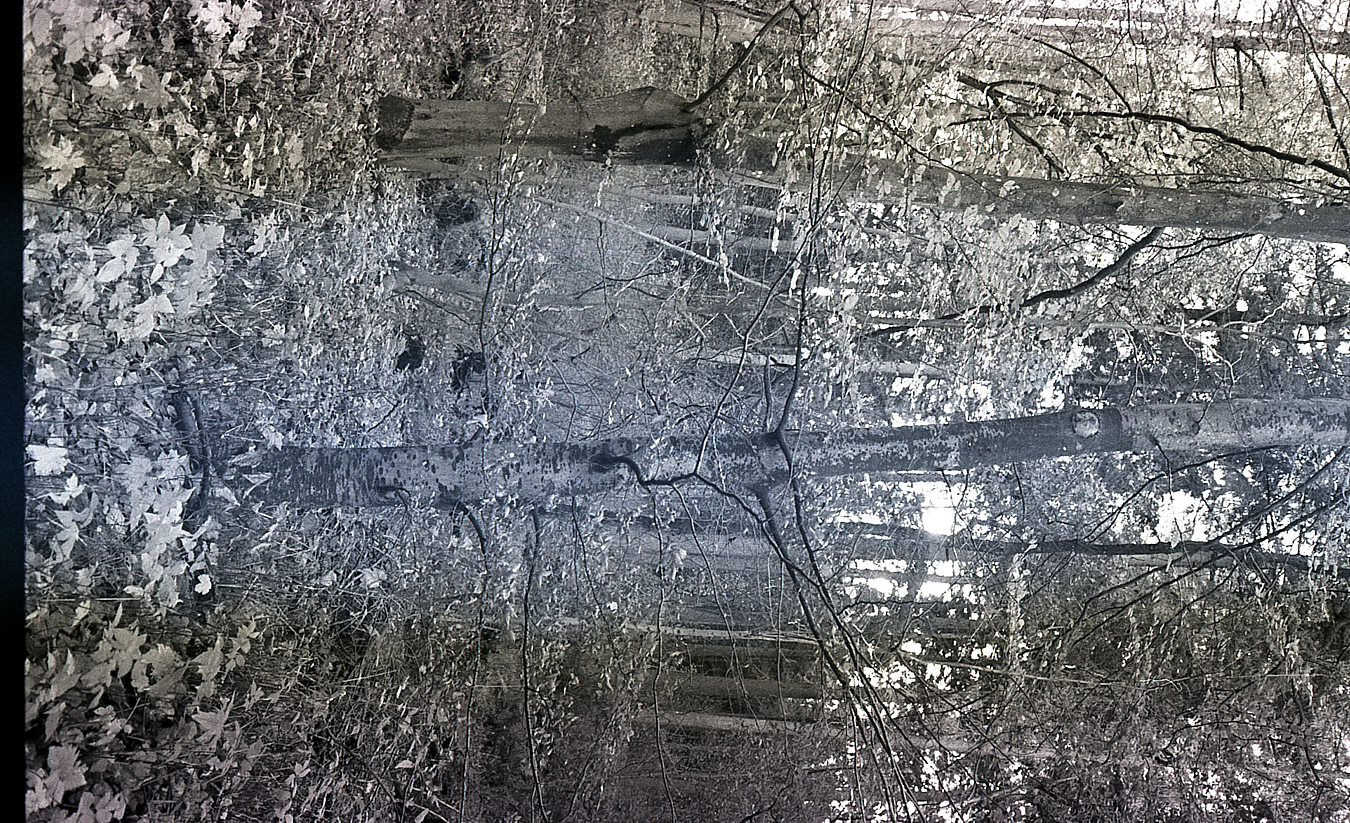

I just developed a roll of delta 400 taken with a Yashica Electro 35. But I think I messed up the development. Here are some scans with no corrections:
I have scanned them as 48-bit color, 2400 dpi with Epson Scan. This clear area goes through the whole roll more or less, sometimes very present, other times more diminished.

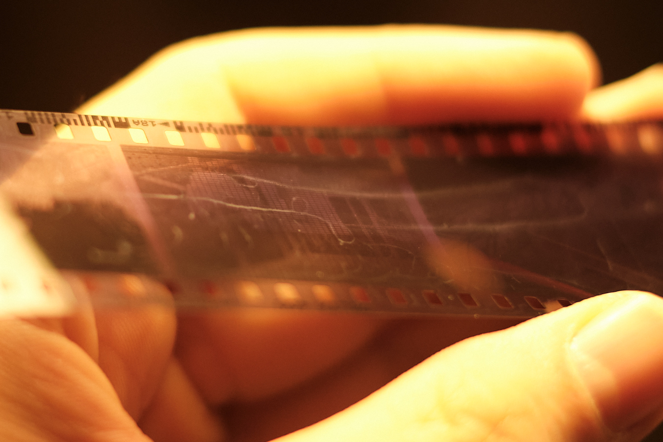

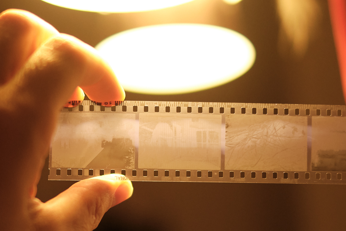

Here is the film, while I hold it up to the light. You can clearly see that streaks here. The film must have been in contact with itself on the reel while I developed it...? With the tightness, I must simply have rolled it wrongly in the reel.

I would put my bets on insufficient fixing, especially when the middle area of the film is kind of milky. Refix in fesh fixer as soon as you can and rins and dry again.

Yes, looks like a fixing issue.
#3 also looks like water spots or residue left after wetting agent. Easy to remove by cleaning the negative.
