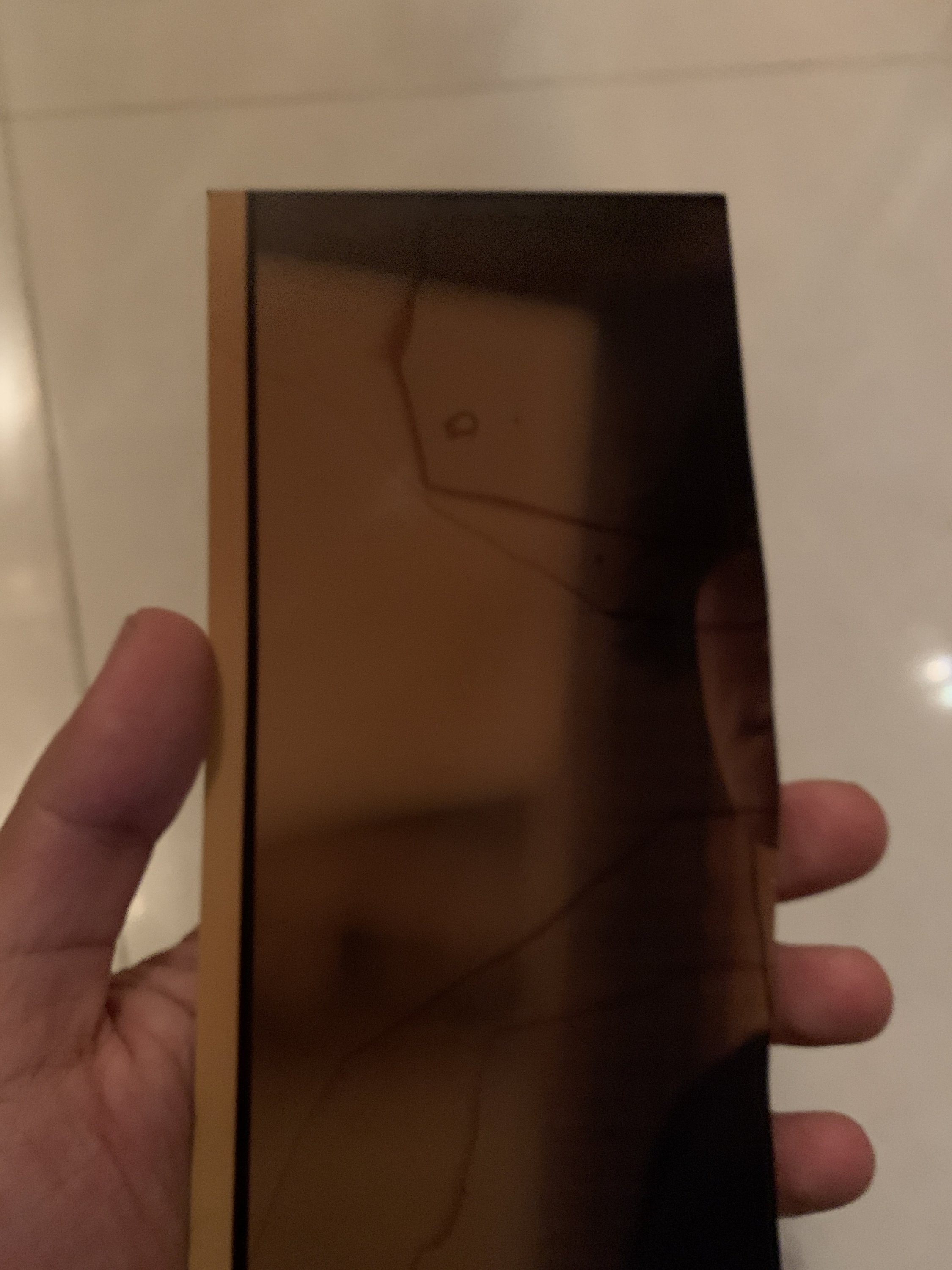

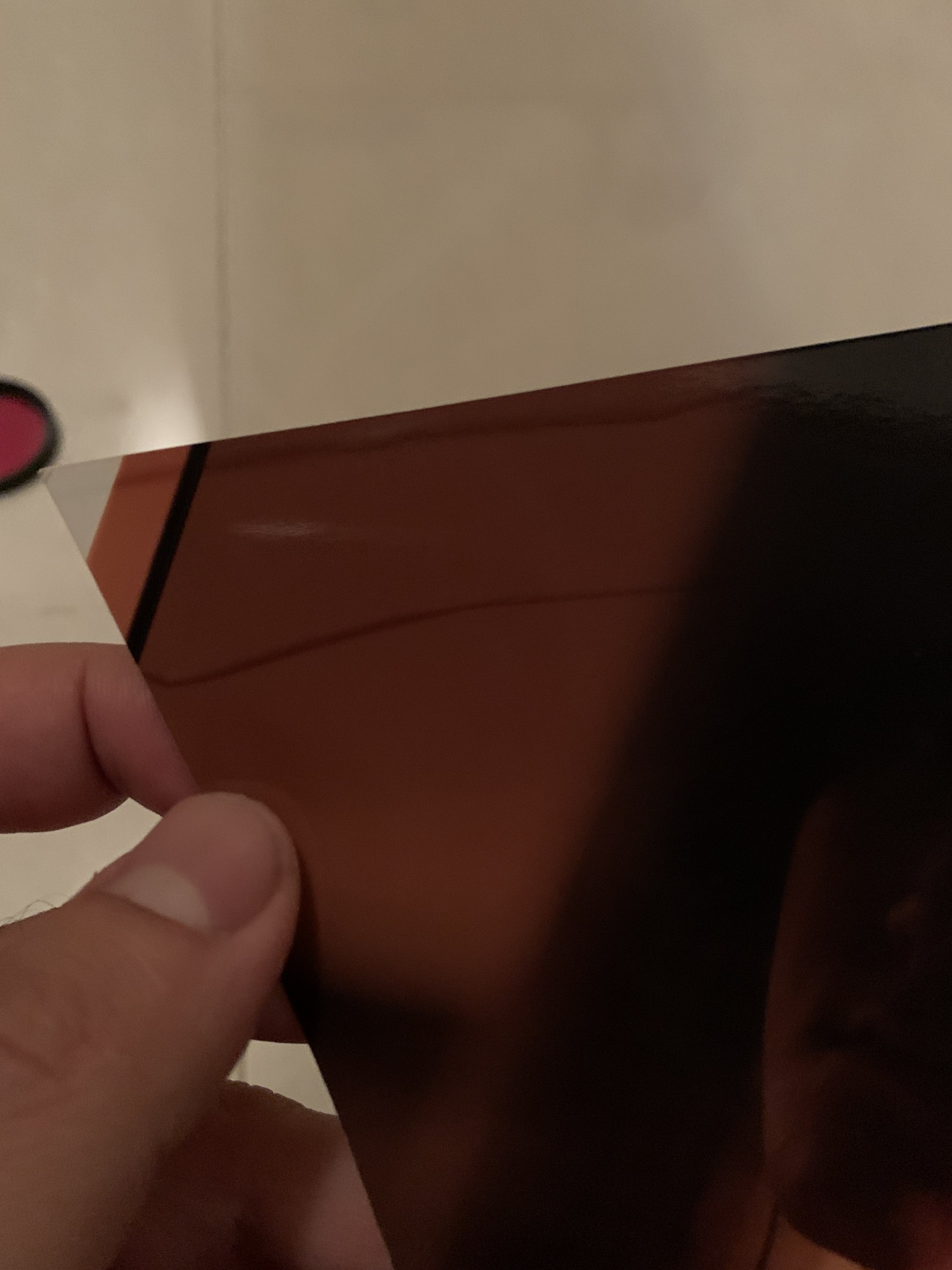

Just done my first session of printing, I came across this issue, these lines here.
I'm processing in a 8x10" drum unicolor unidrum II with a rotary base, pre-wash 40 seconds, develop 2 minutes, blix 2 minutes, then rinse and wash a couple times. I'm using the Tetenal RA-4 kit.
I'm using Fuji CA II paper.
Enlarging with an LPL 7700 PRO
I also tried without pre-wash, with a dry drum.
Any ideas what might be causing this? Thank you!

Just to be sure - you're handling the paper in absolute darkness?
Any chance of posting some better photos? It's really hard to see on these what's going on.

In the absence of other information the usual cause of streaks when using roller processing is usually incomplete rinsing the drum between chemicals and then drying, or in some cases just the lack of drying where any remaining water dilutes the developer so making the development uneven.

Thanks guys! I solved the problem! It was the way I was pouring chemicals into the drum. The paper is also fogged from some light coming from the back of the enlarger. Now I have another problem, Newton rings, how do you guys deal with that?

Yes, that makes sense; it's nice to hear you solved the issue.

I wonder if those are development streaks at all. Looks more like a light leak issue to me. But I note you already discovered the source of that. As for your other question, every one of my enlargers is equipped with carriers having anti-newton glass on BOTH sides of the film. I can't imagine life without this. I do this for every format, 35mm all the way up to 8X10 sheet film. Getting truly sharp prints without a tight glass sandwich is nearly impossible. And in my climate at least, avoiding rings can only be consistently done with true anti-Newton glass on both sides. Done correctly, there will be no visible pattern in the print itself, or any loss to fine image detail. Recently I got a new set of AN glass for my 8X10 cold light enlarger from ScanTech in southern California. Nice product. They can custom size anything you need, and carry plain enlarging glass as well.
