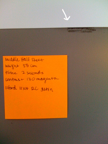

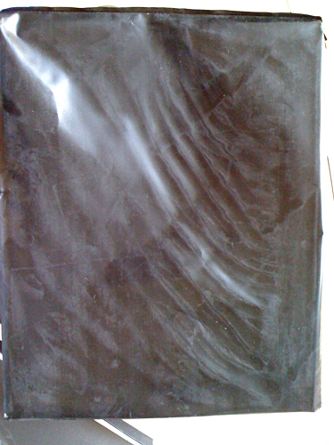

I just opened a new box of Ilford Multigrade IV Deluxe MGD.25M VC RC Satin 11x14 paper. It was a box of 50 sheets. After exposing the first sheet I noticed some black streaks mostly around the edges. I then exposed a sheet from the middle of the pack and found more streaks (like cross hatched lines) around some of the edges (not the same edges as the first time) and some streaking in the middle of the paper. The paper is not fogged at all either. I was confused so I tried developing unexposed paper and those pieces came out completely clean but when I flashed other paper, the streaks appeared. This isn't the only box that this happened to. The other weird thing is the black plastic bag that the paper comes in was totally powdery. It's a black powder. I do live in Hawaii so I'm afraid that it may have something to do with the shipping? But how would those streaks be so random throughout the stack? Has anyone else had this happen?

This is very odd.....can you send me the batch number from the box I will make some checks : You need to take the product back to the shop you bought it from or ship it back, it will then come back to us to be checked. The black bag the paper comes in is specially treated and they can 'feel' powdery' but no residue should emanate from or off the bag.

Hi Simon,
Thank you so much for looking into this for me. Like I said, it happened once before and I had someone else try and print with it to see if it was me and when he developed an unexposed piece, it came out clean so we all assumed I had done something wrong maybe with my printing. I really couldn't figure it out so I chalked it up as "just one of those things". Now I'm really sure it's not me. The number on the back of the box is 11A572X13 and the bar code is 1949877223

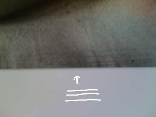

Here are some images to show you what I mean. I took this with my crappy phone as it is the only digital I have. Sorry.

Hi Simon,
I have a Thomas Duplex safelight. I will run another safelight test tomorrow since I haven't done one in a couple of months. I'll also look for any darkroom leaks and reflections. I figured that if it were fogging of some kind, the exposure would be soft not hard edged like my second image. It also is not contained only on the edges. In the 4th image, it's in the middle and kind of big, like 1" x 2". I also made sure my tray was clean so there is no mucky residue. If you can give me any other tests to try, I will gladly do them because I would hate it if I returned a totally usable box of paper if it were preventable on my end. I really do appreciate your looking into it on your end. I think I'm the only one in the islands to use this paper so I have no one to ask about it. It seems to only happen to my 11x14s too, weird.
